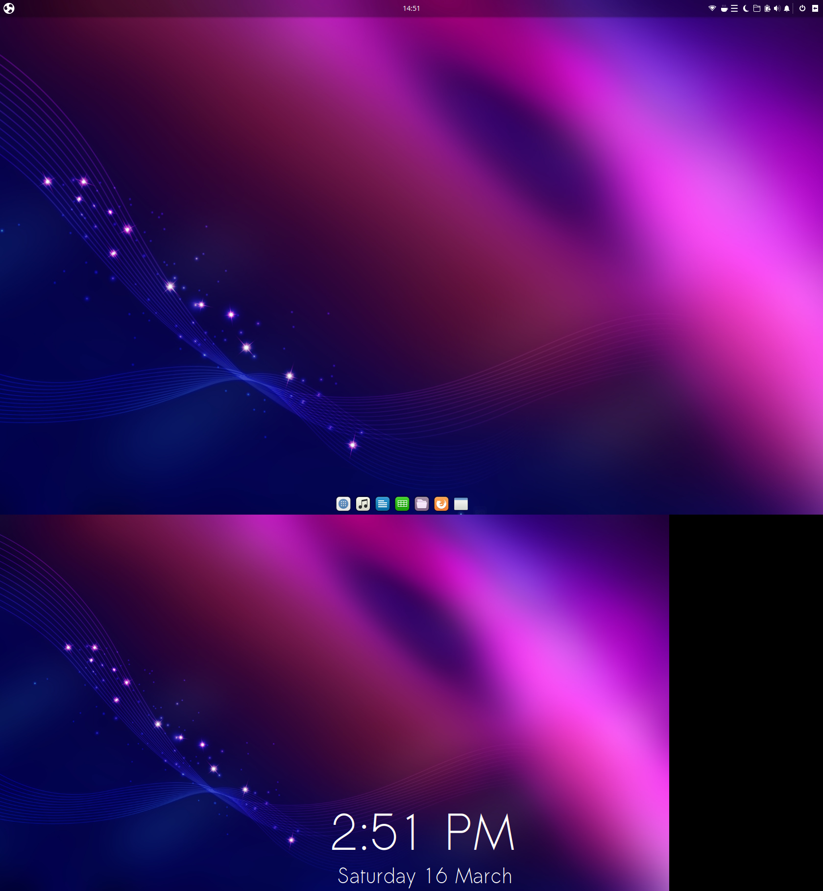

I have noticed the following bugs in the ShowTime Applet. I’m fully updated as of today at 3:00pm EST on 3/16/19. The ShowTime applet often appears in unexpected places when I first login to the Budgie Desktop. The screenshot below illustrate this behavior. Sometimes the ShowTime will even show up on the lower screen of the dual monitor arrangement that you see even though I don’t have this set as the primary monitor.

We had a thought here. Can you temporarily unplug your second monitor and see if the issue still happens? Then we can try to determine if this is related to dual monitors, or an issue across single as well.

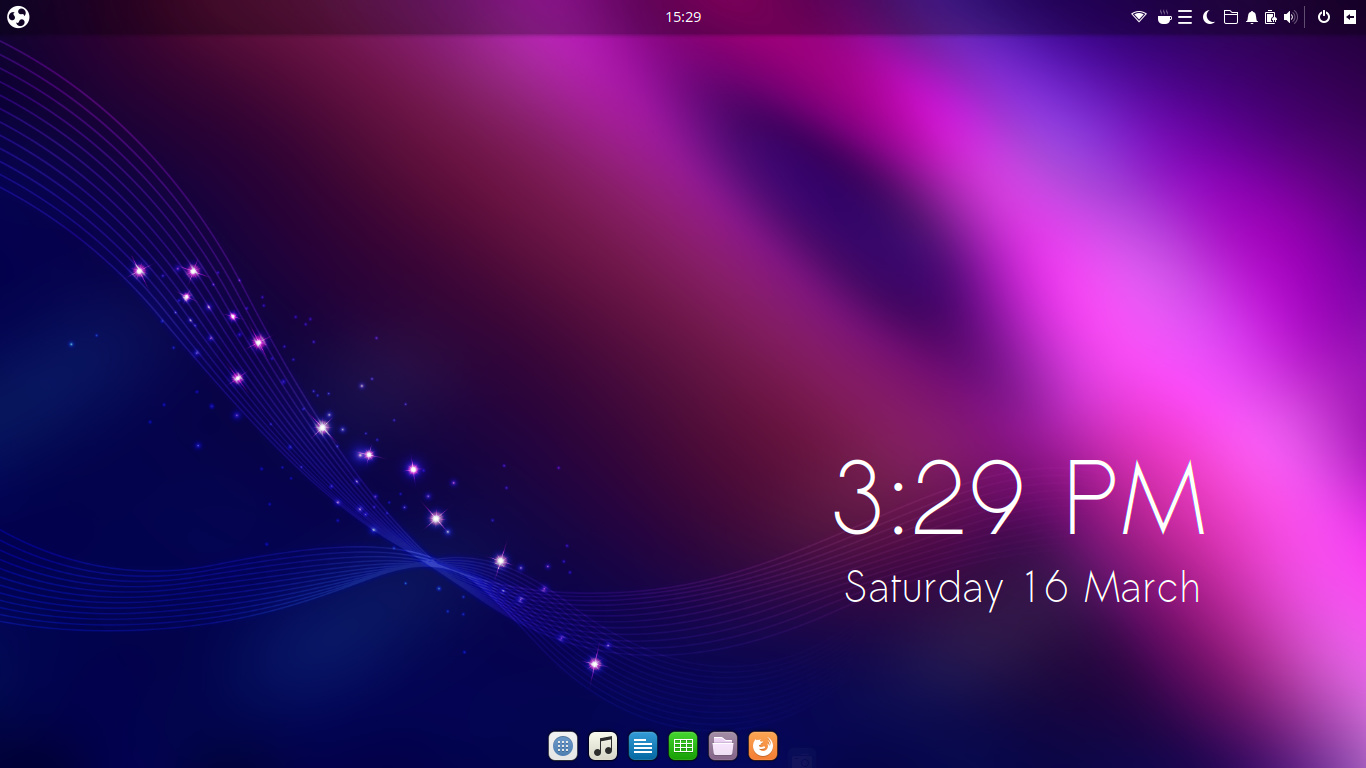

I have tried unplugging the second monitor that I use as my primary and tried logging out and in 3 times and ShowTime always appeared in the same place as noted in the screenshot below. It also remains in that position when “Budgie Desktop Settings” opens unlike when I opened “Budgie Desktop Settings” with the dual monitors and ShowTime would suddenly jump to the expected spot on the screen. I kind of feel like the position is a little off, not quit into the lower right hand corner of the screen to my eyes.
![190316ShowTime-single](https://cdck-file-uploads-canada1.s3.dualstack.ca-central-1.amazonaws.com/flex035/uploads/ubuntubudgie/original/2X/5/569f49f10c5f1b6cd9dd4aa2b244c2450753563e.jpeg)
I still have the issue of the “grayed-out” settings for ShowTime making it impossible to change any of the settings for the applet.

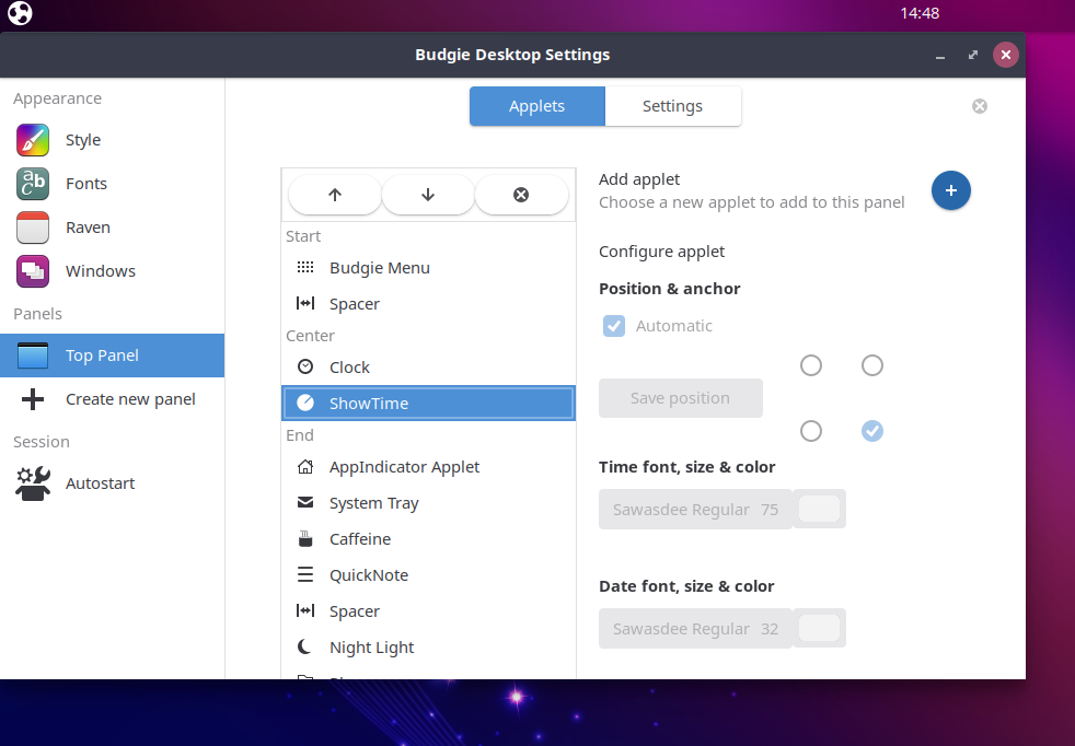

…at the same time: if all is greyed out, that is the state (deliberately) when draggable is on. Did you by any chance forget to tick “save”?

All the settings are “grayed out” when I first open “Budgie Desktop Settings”. I can’t uncheck “Automatic” or change the Time font, size & color or any of the other settings. So I can’t even change the position of ShowTime and click on “Save position”. The settings were all “grayed out” when I disconnected the external screen too. Hopefully this shows in the screenshot below:

I have the feeling your dconf path is messed up, possibly the remains of an error before you updated to the latest showtime version. Apparently your showtime window is draggable currently. Could you close the settings window, run `dconf reset -f /org/ubuntubudgie/plugins/budgie-showtime/`, then log out/in again and see what happens.

I ran that command, and that fixed the “grayed out” options. Also did some tests, logging out, restarting, shutting down, and ShowTime seems to stay in the same place now.
