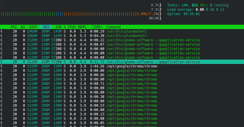

@fossfreedom, i haven’t been able to pick up one culprit in htop… it seems that it is a Gnome desktop issue, though. I’ve switched over to KDE plasma in the meantime, and memory usage is now under control again.
I am still seeing quite a bit of memory associated with gnome-software, though… can’t yet figure out what this is…

I was watching htop yesterday, and all I could see was the used memory increasing, but no one culprit. The increases I saw also did not correlate with the way the used memory was increasing. At this time, I can only say I am really puzzled :face_with_raised_eyebrow: and a bit sad, because I like Budgie very much
