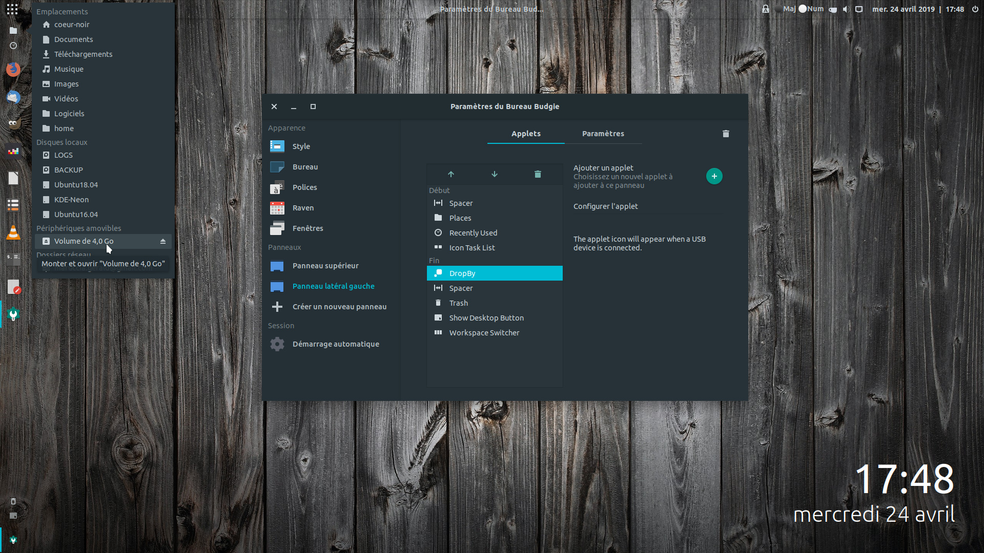

Yes :wink:
Capture%20du%202019-04-24%2017-48-01
Should be visible a little above the trash.
Sometimes when I insert a usb stick it happens to pop a dark grey arrow near the panel where DropBy icon should appear as if its window could not be drawn.
I can’t manage to take a screenshot of this because as soon as I click anywhere on the screen, the little arrow disappears.
