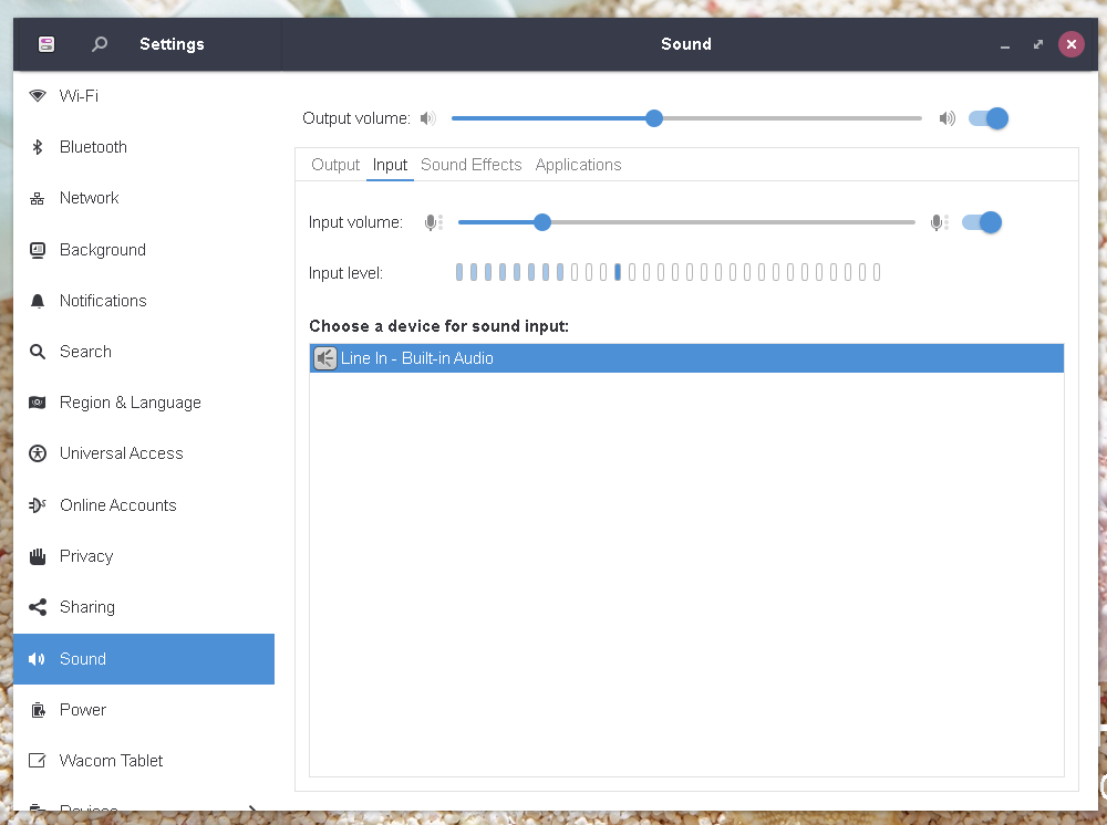

I need help with my budgie . In my budgie when I connect input for line-in , there is no sound can be hear from the line-in adapter even it is supposed there is sound in the line-in. The other sound is working properly just that from line in is not out.
IScreenshot%20from%202018-11-12%2021-45-11%20cropped
I checked the sound setting there supposed to be sound in.
Anyone have same issue and can fix this ? Thank you
Are you trying to route sound from Line In through the speakers, or do you just want to hook up a pair of speakers? Line In is meant for recording audio, Skype calls, etc. but there is a way to route Line In through the speakers if that’s what you’re looking to do. If you just want to hook up speakers, you should connect them either to Headphones or Line Out.
Yes I want to route the sound from line-in to the out speaker so I can hear the sound.
" If you just want to hook up speakers, you should connect them either to Headphones or Line Out."
What and how do you mean ? Do you mean that I must connect the cable to line out ? Thanks
line-in is for a microphone i.e. to record sound
line-out is for a headphone or speakers.
Why would you be trying to play sound through a microphone socket?
Oh. My speaker is already connect with the line-out. What I want to do is to make the sound to the line-in go to the line out -
Sound -> Line in -> Line out -> Speaker
There is sound to the line in but the sound is not coming out from the speaker in my case
you’ll need to use a loopback device to do this: https://askubuntu.com/questions/211136/get-the-audio-from-line-in-to-output-to-the-speaker
Pavucontrol will help you « manage » sound inputs / outputs / monitoring…
https://doc.ubuntu-fr.org/pavucontrol
Thank You . This worked for me :+1:
