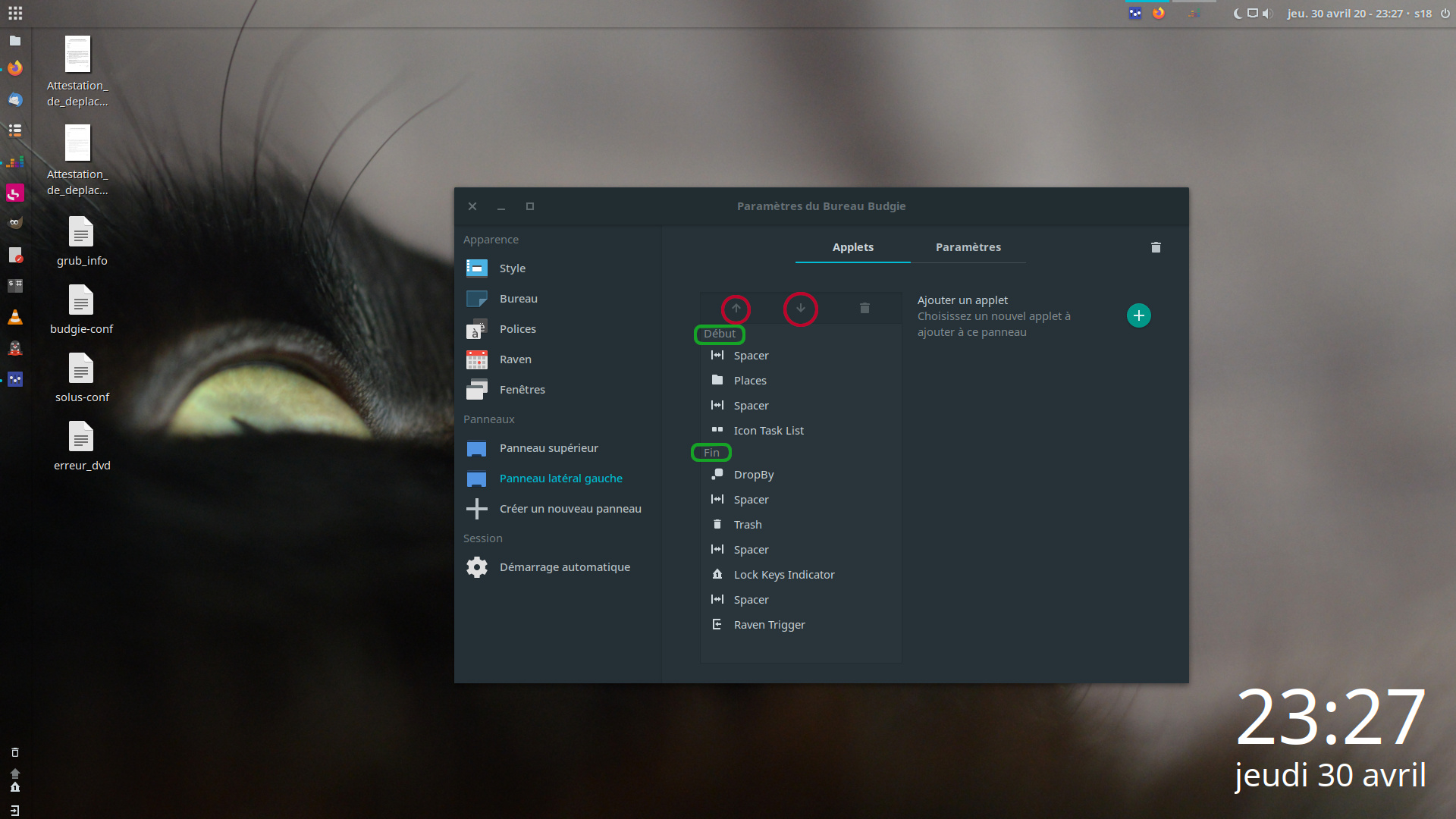

By default, when you add an applet to a panel, it’s located in its center part.
You may select an applet in the list and then move it to beginning or end of panel :
Here there is no applet in center part.
