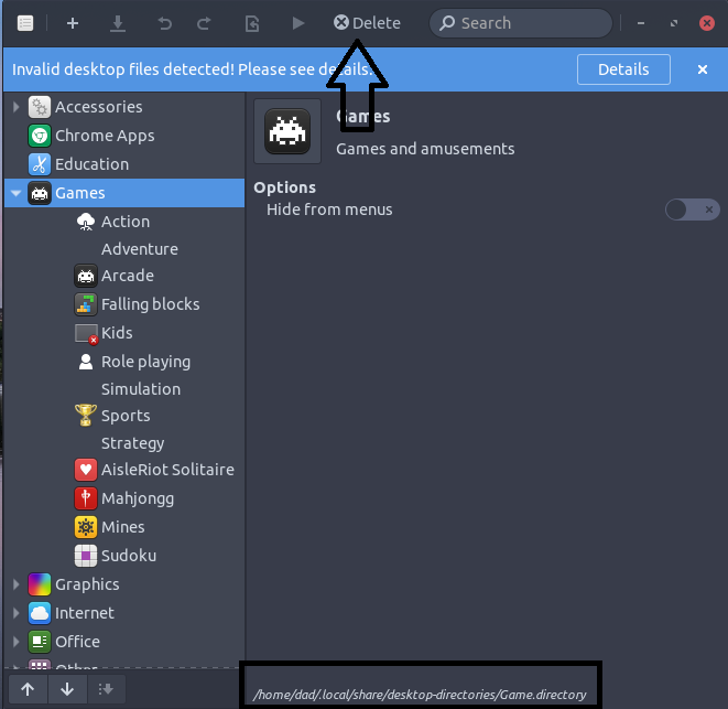

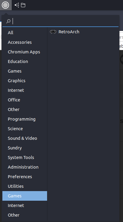

Not sure if this is related, but System Menu also created duplicate categories of the apps i edited.

Any way to at least reset the menu?

Click on the folder (Games in the picture) and look at the bottom of the app - if you see /home/yourname/.local… then click the Delete button. Dont worry about the warning message - it will just delete the local copy of the folder.
