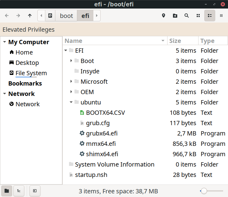

For peace of mind and to give you a visual idea, here is what the ‘/efi’ directory contains when GRUB is installed on nvme0n1, as indicated in the ‘Someting else’ option — this is precisely my configuration:
As for the contents of the file ‘’efi/EFI/ubuntu/grub.cfg’, here it is:
search.fs_uuid c8d21106-612c-4ef3-9ba4-0df2b7a6462e root
set prefix=($root)'/boot/grub
configfile $prefix/grub.cfg

To answer your summary, yes, that’s what is happening, even if you are making things a bit more complicated: Ubuntu distributions (derived from Debian) put their kernels in the ‘/boot’ directory of their partition.
So, as I showed you, the ‘grub.cfg’ file in the ‘EFI’ directory points to the ‘grub.cfg’ file in the distribution’s ‘/boot’ directory, which contains the paths to the different versions of the kernel.
