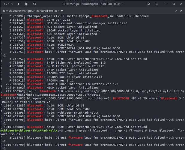

I searched and read yesterday that Broadcom does not suport bluetooth firmware updates. I tried the detection steps here: https://github.com/winterheart/broadcom-bt-firmware and saw firmware failures. I will research more and see if I can get the latest firmware loaded.
In case this is of use:
That does very much look like the key issue … the firmware is not loading so bluez is defaulting to a mode that doesn’t really work.

I tried the suggestions by @fossfreedom as well as the Broadcom firmware update on the github post. The mouse has been working for two days now with only occasional dropouts (that last for up to 15 seconds or so). I wish I had been ore methodical and tested to see which “fix” actually worked. I rebooted after each adjustment but the mouse only started working the next day after the system being off overnight. Thank you for your support.
