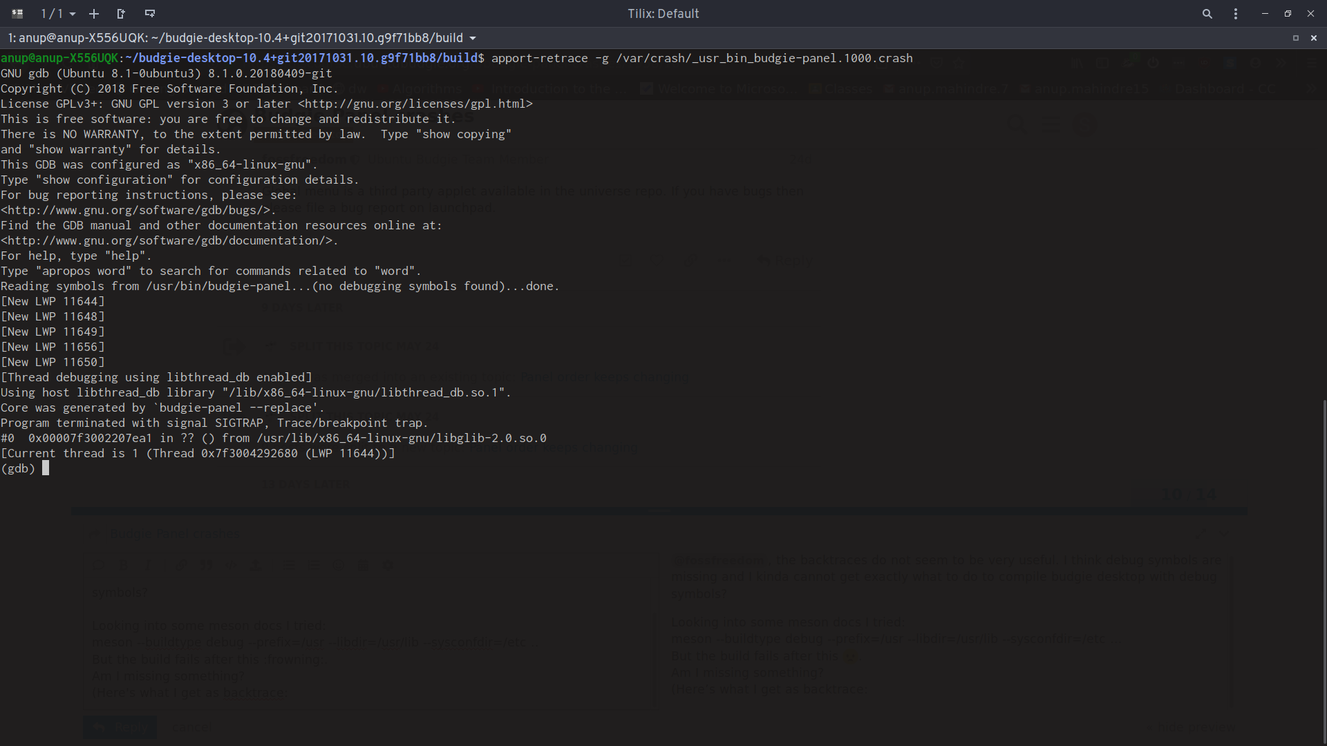

After doing this (from the split thread) and keeping the laptop on for some days, now it has reached a state where the panel consistently crashes after restarting. I might be able to keep my laptop up for sometime in this state, so is there anything that I can do to help debug the issue, since it is getting reproduced consistently now? @fossfreedom
Since you have got a self compiled install you’ll be able to look a the crash file produced and examine it to find out where in the code it is crashing:
and
@fossfreedom, the backtraces do not seem to be very useful. I think debug symbols are missing and I kinda cannot get exactly what to do to compile budgie desktop with debug symbols?

Am I missing something? (Also notice that crash is in libglib so maybe that’s why backtraces are not helpful
(Here’s what I get as backtrace:

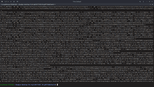

Somehow this does not work for me. plain buildtype works fine but debug fails. Also tried fetching sources again and building without any changes from my side to ensure my changes are not causing build failures.
Plain build type:
Debug build type:
Look at the top of the screenshot … the .ccache… subfolder has a permission error. Looks like the subfolder has somehow changed permission rights from your account name
Yes realized that. Must have happened as I ran one of the commands in a elevated terminal
Sorry for the trouble.
