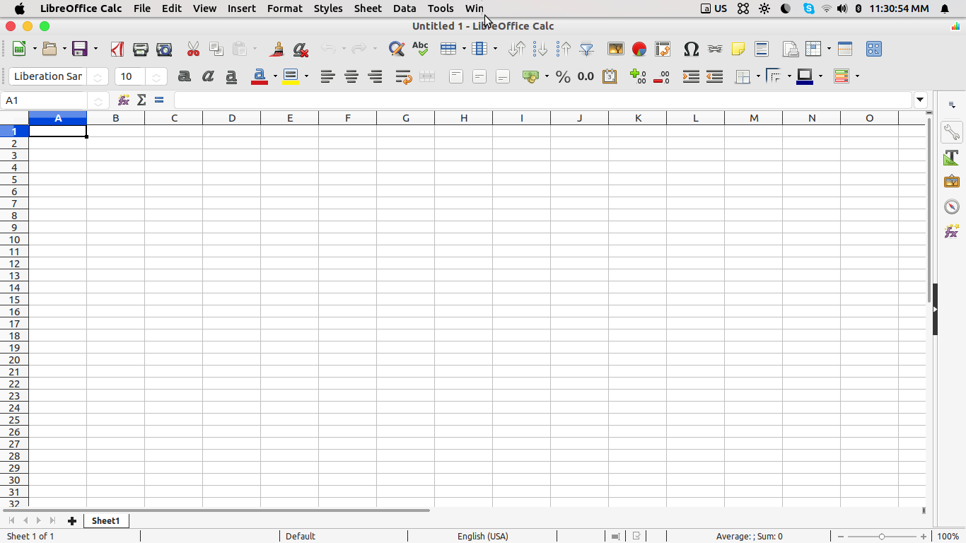

Is it possible to add, in ubuntu budgie 18.04, an expand option to global menu applet settings so for some apps like libreoffice suite, global menu does not cut off ? See attached picture.
Screenshot%20from%202018-03-13%2023-30-55
please file an issue request on the upstream tracker - thanks
As an aside, whatever theme that is - it seems to be introducing a large space between menu’s - so that needs to be investigated with whoever maintains that gtk theme.

I have noticed same issue on my Ubuntu-Budgie 18.04 : ( long ) global menus looks truncated if set at the left side of panel.
But it is ok, if set at the center of panel !
So it might be related to how the panel works ?
@Coeur-Noir can you add a picture for the left aligned global menu and another picture for the centre aligned? Not sure I understand your comment … pictures paint a thousand words ! :grinning:

Is there is a kind of Z ( depth ) order for each part of panel,
left is at background,
right is just above left,
and center is at the top of both ?

can you double check if this is a conflict between pixel saver and the global menu - can you remove pixel saver (logout and login) from the panel and check if the global menu works (or not)
Without pixel saver :
budgie_global_menu_left_no_pixel_saver
…« fenêtres, aide » are missing, « script-fu » is truncated at same position, center of panel.
Same if there is only global menu at the left, and nothing else in panel, before you ask :wink:

Are you sure it’s a problem « inside » this applet ?
Isn’t it something related with the way budgie-panel organizes its different parts [ beginning | center | end ] ?
Reading the upstream tracker, the dev thinks it is due to a change that was made by the applet itself - it used to work before the change.
Thanks for explanations, as usual :wink:
Well, maybe he thinks otherwise https://gitlab.com/vala-panel-project/vala-panel-appmenu/issues/222#note_90787024 :smile:
Sounds like he just threw his arms in the air …!
Needs someone wonderful to investigate how applets are sized and why there is a difference between left align and centre align
No, I am not thrown my arms in air. I know exactly why this happens, and I explained it now (but I think this is by design and will not be fixed)
Good to know about the centre box issue. Maybe somehow there is a way to hide the various boxes if they don’t contain applets. As you say it is something that someone fiddling with the codebase could try to do and propose a patch to upstream.
