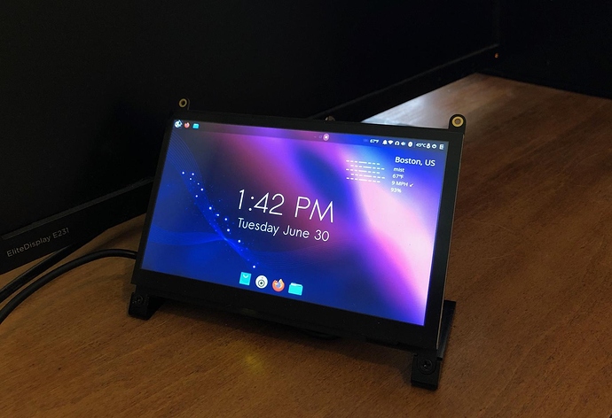

I haven’t had any real issues with it since. I just got a 7" touchscreen for it yesterday. Before that I was testing the multi-monitor with a tv and regular monitor. It all just seems to work.
I am not saying this needed to exist, but it does now…
UB in a 7" form factor: (and works quite well - uptime 6+ days already)
