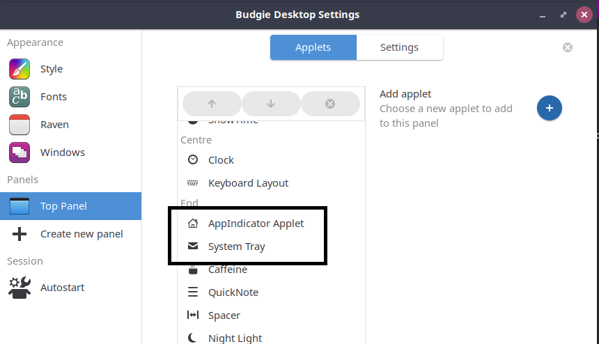

Have you got the application indicator applet and the system tray applets added to your panel?
Think mozc icon displays on one of those applets.
No. How do I do that?
Open budgie desktop settings from the menu - click on your panel and check the list of applets displayed.
If they are not on your panel - click the + button to add applets.
I’m not exactly sure what to look for, but I have got the Keyboard layout indicator there. That got Japanese to work in the beginning. Now it just let you chose between languages the same way the language chooser does.
Have you got those two applets in your panel?
Yes, they are both there.
