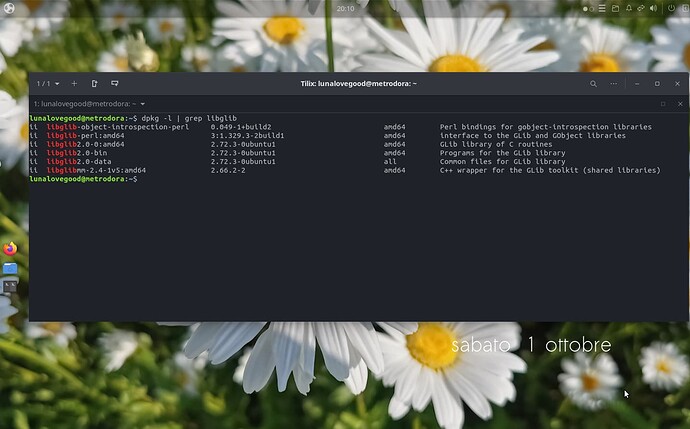

Thanks fossfreedom. I was thinking about the fact that until … maybe last week or two weeks ago I didn’t meet any problem in lazarus installation, both from repo and from packages downloaded from Lasarus Project site but, as you made me notice, my sources.list is heavily modified; so I’ve downloaded a brand new budgie iso and installed it on a qemu VM. I didn’t touch anything from fresh install, just added binutils and gcc, needed by deb files.
Trying to install lazarus (both from repo and from deb), I got the same unmet dependencies error; giving a apt -f install simply removes lazarus, while trying to downgrade libglib2.0-0 to 2.72.1-1 version (using apt -s!!!
) has the result of removing the entire budgie DE, DE manager and other “vital” stuff (so I didn’t downgrade anything).
Then I’ve made another qemu VM from “standard” Ubuntu (gnome DE, I suppose) and configured exactly as Budgie one (no modifications after install, just addedd gcc and binutils): trying to install lazarus on this machine too, I’ve got the same error about libglib but giving a apt -f install solved the problem.
If I give a dpkg -l | grep libglib on both machines, I get:
libglib2-0-0 → 2.72.3 on Budgie
and
libglib2-0-0 → 2.72.1-1 on gnome
as you can see in attached screenshots.
Is it possible that this depends on (maybe) some recent Budgie DE upgrades? The two machines, besides DE, were identical.
