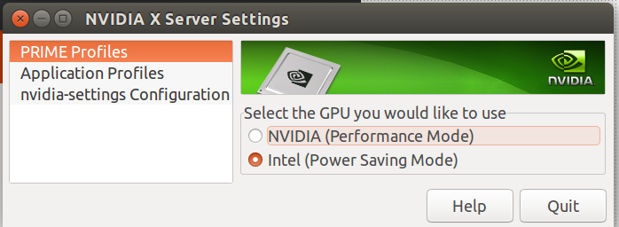

I’ve recently purchased a Matebook X Pro and experienced most of the problems all you have reported (firstly with Ubuntu, now trying with Fedora), being the most important, for me, the high power consumption:
I’ve tried with both NVidia and Nouveau drivers, both seem to be high consuming, but I think the real problem is I’ve never switched to intel graphics card (which I would!). How this is done? I didn’t had a lot of time to dig into it, but I think I have to reach this:
is this right?
Being that the case: do I need to install the NVidia drivers (via the “additional drivers” control panel) and then start the nvidia-settings?
Welcome!
Certainly that is the correct screen to switch between intel and nvidia graphics.
Yes - if you open the Additional Drivers window it will offer you the drivers most appropriate to your computer. Install the nvidia driver. After a reboot you will see an nvidia option in your menu that will open the above window.
Hi there. I’m on a Matebook X Pro at work, although I’m running Manjaro KDE on it in that setting with the integrated Intel (although I’m running Manjaro Budgie and Ubuntu Budgie on other machines and can still give some perspective). On that, according to Powertop, with about 28% screen brightness and TLP running, I’m discharging about 5.5W, which gives me about 10 hours of battery life and is running Linux fairly flawlessly.
From what I can see, what you’re doing to activate the Intel GPU is correct in Prime Profiles and should work. Here’s the thing, though. I’ve found the Matebook X Pro doesn’t play nicely with some of the newer Kernels. I’ve downgraded mine to 4.14, and get the power consumption above. If I go up to 4.19 or 4.20, power consumption is cut in half (even though, in theory, those kernels have more advanced power management). The same is true of my kids Xiaomi Laptops running the above Budgies. If I put 4.20 on, those machines get 2.5 hrs. If I use the 4.14 kernels, battery life jumps to 5.5 hrs. Go figure.
Now, to be honest, it’s been a while since I changed kernels in Ubuntu and can’t tell you off the top of my head how to do that (that’s what Google’s for, I guess), but in Manjaro it’s incredibly easy via a GUI app. Try this out and see how that works!
Addendum: Just checked the 5.x kernel on my kids Manjaro Budgie Xiaomi laptop, and it’s performing far better than the 4.19 or 4.20 kernels, with 3.81 W of discharge with no apps running (vs 8.5-9 W in the other kernels and about 4.3W with the 4.14 kernel). I’ll try it on the Matebook X Pro tomorrow.
