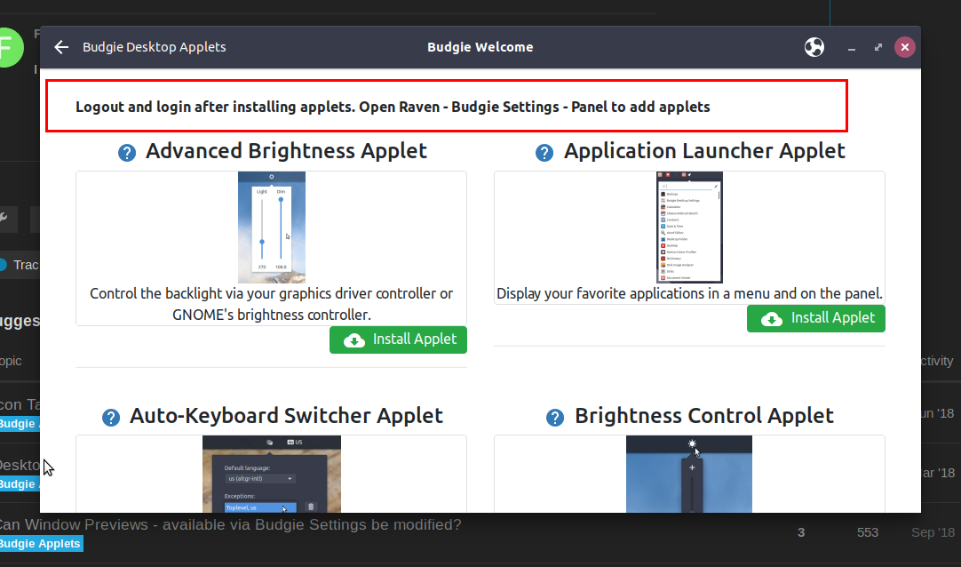

It’s in bold text right at the top of the budgie applets screen.
Is there a better way to highlight this “how to”?
I do not see any bold text there?

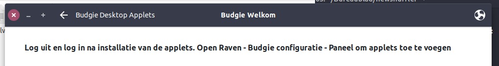

I am Dutch and have the Dutch version of Budgie. In Budget Applets there is bold text to go to Raven. but in the Dutch language Budgie version “Raven” is not available in the menu search. Raven is called “Budgie Bureaublad Instellingen” in the menu. So the translation from Raven to Budgie Bureaublad Instellingen is the solution.
I know now
Ah. That explains it. Could you please fix this by updating the translation?

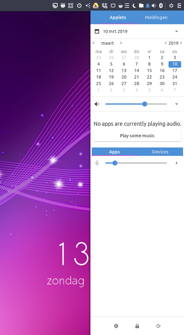

@anon90456597 Waitwait something is wrong here: “Budgie Bureaublad Instellingen” in Dutch = Budgie Settings!, not Raven. This is Raven:
Raven is called by pressing the button on the panel - top right:
… and is also in Dutch called Raven:
I will do nothing until somebody clarifies the situation. Budgie settings I understand. And the side bar is called Raven. But “Open Raven-Budgie configuratie-Paneel om applets toe te voegen” is still a mystery for me. There is no way you can get into settings there as far as I can see.
Looking at your image Vlijm, I see that in my Raven the 3 buttons below are missing. Could it be because I am running Budgie on a Asus X-202E? 11" netbook?
Ok - I’m going to change the message to this:
“Logout and login after installing applets. From the menu - choose Budgie Desktop Settings and choose the Panel to add and configure applets.”

@anon90456597 right, the directions were indeed a bit confusing. The changes @fossfreedom suggests will make it much clearer. Furthermore, you are missing the three buttons at the bottom of Raven because they are only there if you set “Shower Power Strip” from Budgie Settings. I forgot that they are not there by default on 19.04 (they were on previous versions).
@Vlijm. Thanks! I am working with 19.04.
