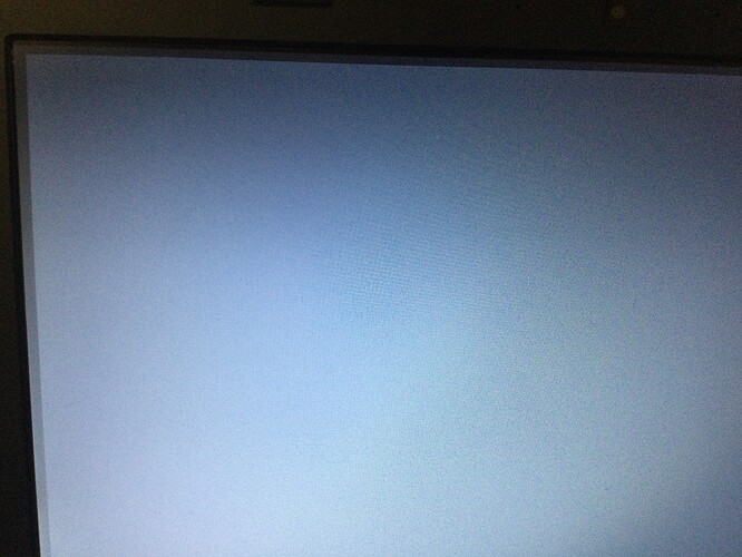

The title basically says it all. Ubuntu Budgie 20.04 minimal install. Very irritating, hoping there is a solution. Dell Vostro 3350 laptop.
Are you dual booting with any other linux distros? Maybe their updates are also updating the same grub?
Only using Ubuntu Budgie on the laptop. The menu background is there, but the menu entries are not visible.
Can you please attach a picture to enable everyone to see what you are seeing please?
If you have only one operating system installed then you will not normally see grub … you should be able to see grub if you press and hold the shift key immediately on booting.
