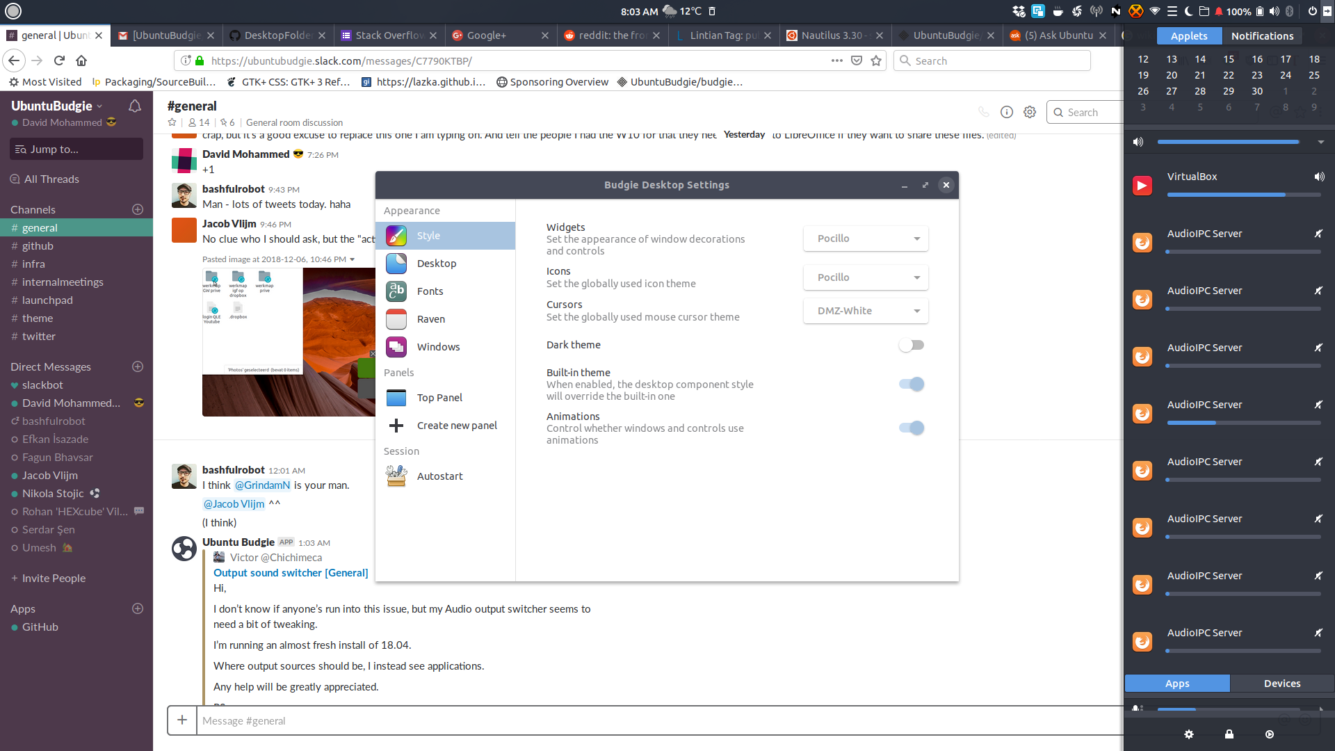

I don’t know if anyone’s run into this issue, but my Audio output switcher seems to need a bit of tweaking.
I’m running an almost fresh install of 18.04.
Where output sources should be, I instead see applications.
Any help will be greatly appreciated.
PS.
I can change my output just fine from the settings menu.

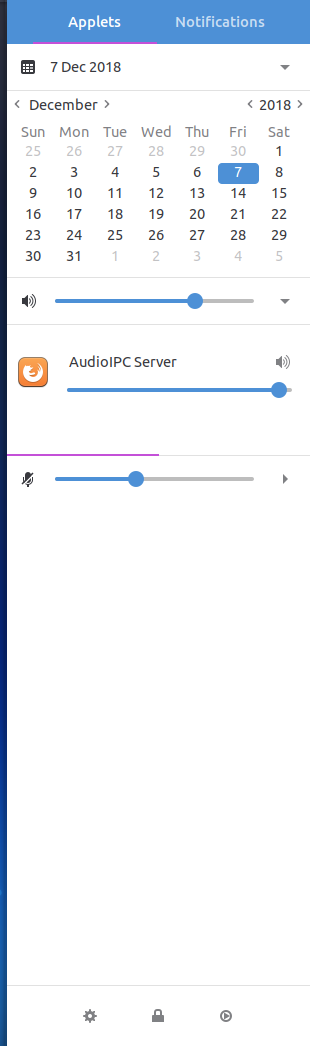

Ah - good spot - it is actually there - but there is a bug in the theme - if you switch on the system theme you will see the Devices button below the last app.
You can click into what appears to be a blank space and it will switch.
The pocillo theme needs a tweak.
If you or anyone wants to have a go fixing that would be most appreciated - we can then rollout the fix very quickly
