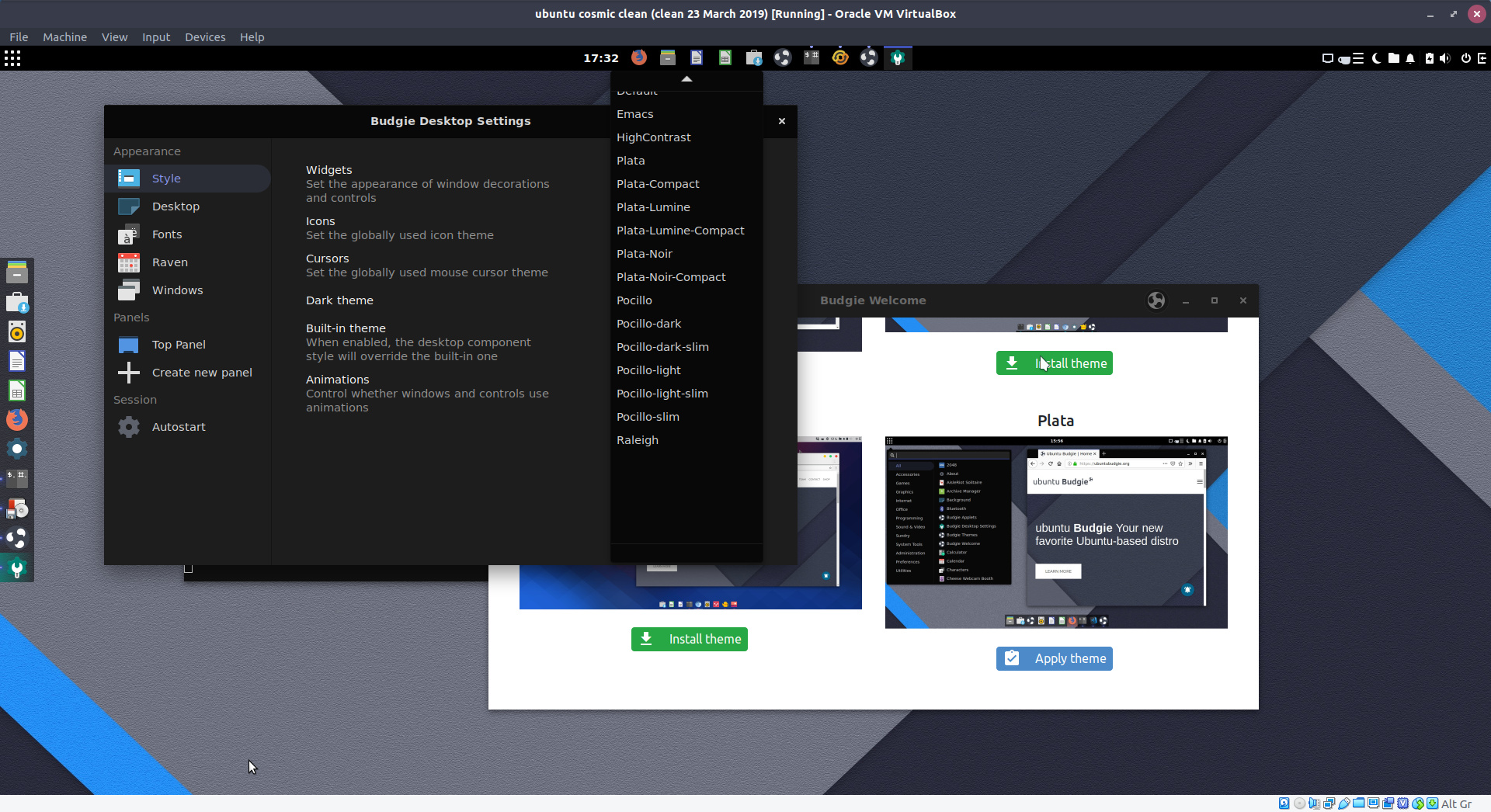

ubuntu%20cosmic%20clean%20(clean%2023%20March%202019)%20%5BRunning%5D%20-%20Oracle%20VM%20VirtualBox_001
As you can see - I applied plata (hit the apply button) just fine on my 18.10 VM - and plata is visible

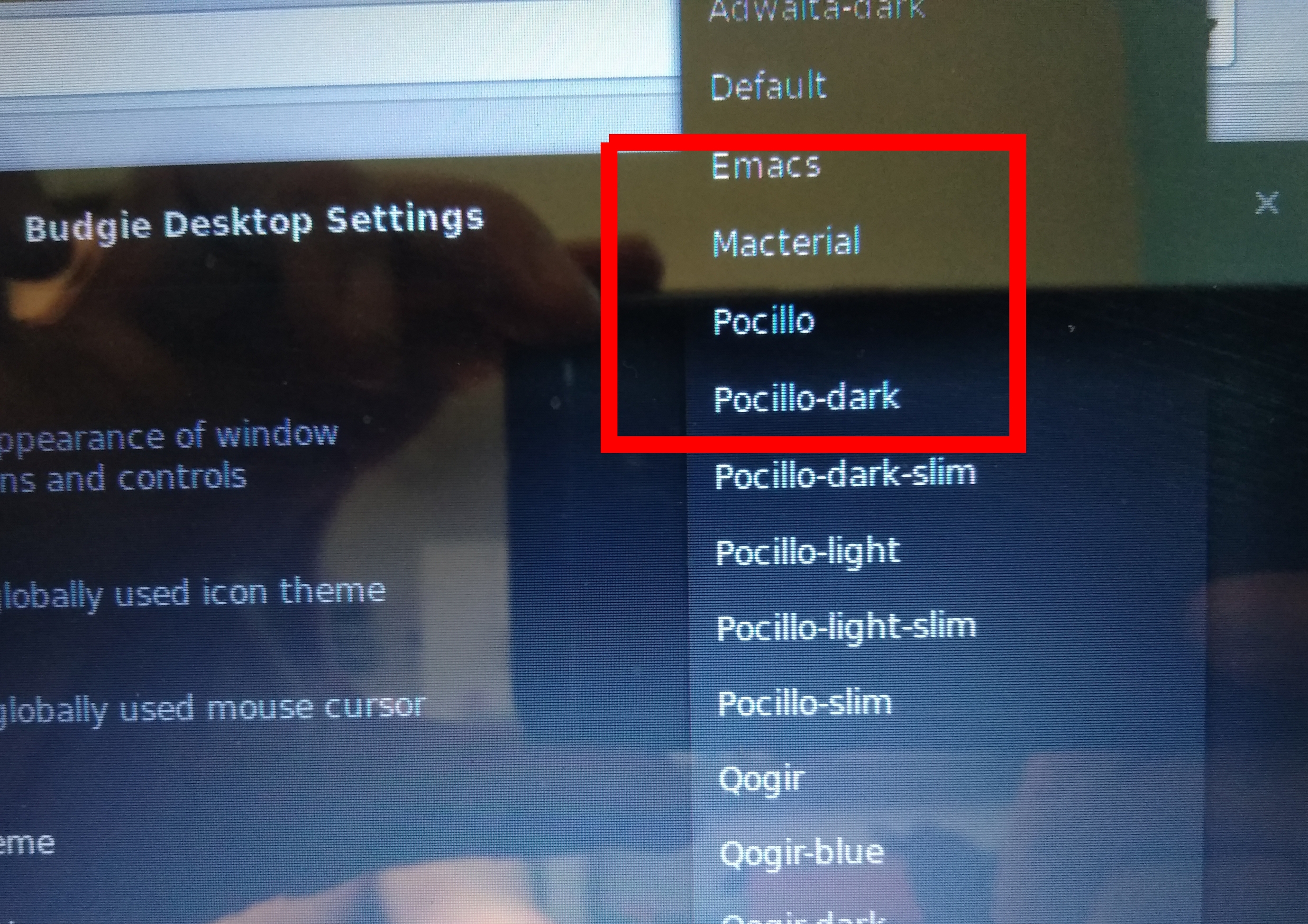

No doubt it is visible on your machine. Now look at mine :
Settings
plata
