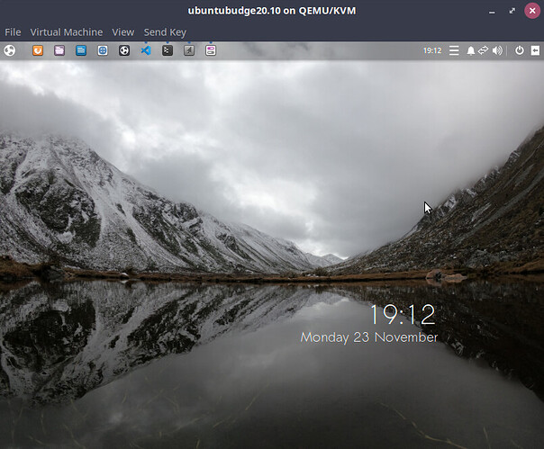

  3. On first logon we need to sense if the connected monitor/screen is less than 1024 px - and invite people to use a more compact layout for budgie - probably something like
  1. This compact layout will need also to adjust font sizes to work better at expected lower Pi resolutions - we are targeting 800x600 as a minimum. Additionally the panel should have autohide set
For the compact layout we should really use the classic budgie menu - ideally with its compact mode ticked - how to tick that checkbox in the applet settings is a really good question!
  1. We know some outputs are 480px high - so we probably should look at a xrandr type solution so that the user can scroll when needed. Remember UB is a desktop solution - all the apps are expecting desktop type resolutions.
