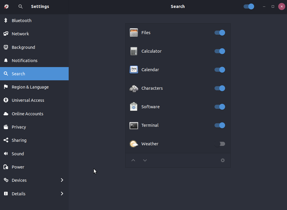

What are these "Search" settings used for?
I’ve been trying figure out where they are used, but they don’t seem to be used for anything? Perhaps they should be removed? Or is something with them planned, or did I miss something :slight_smile: ?

They are not currently used in budgie.
This pane is part of GNOME control centre and cannot be hidden.
I think they are used either by tracker to control what it indexes or by gnome shell search.
In a future version on budgie it has been confirmed by upstream that budgie will no longer need gnome control centre. Where settings are relevant for budgie will be included in an enhanced budgie settings.

Don’t have it open in front of me, but I believe that the settings under the “Notifications” section also do nothing under Budgie.
Someone correct me if I’m wrong, but I don’t believe Tracker runs in the background in Budgie. When you search in Nautilus, it indexes the files ad hoc and gives you the result.

In previous versions, we had worked to remove applications that utilized tracker (resources), and thus tracker itself.
@fossfreedom - Nothing has changed here, correct?
Ah yes. I remember now that you guys were working to lower system resources and that was one of the items that was removed. Probably a good thing since it’s not of much use in Budgie anyway.
No. This is an upstream issue. See the bug report
