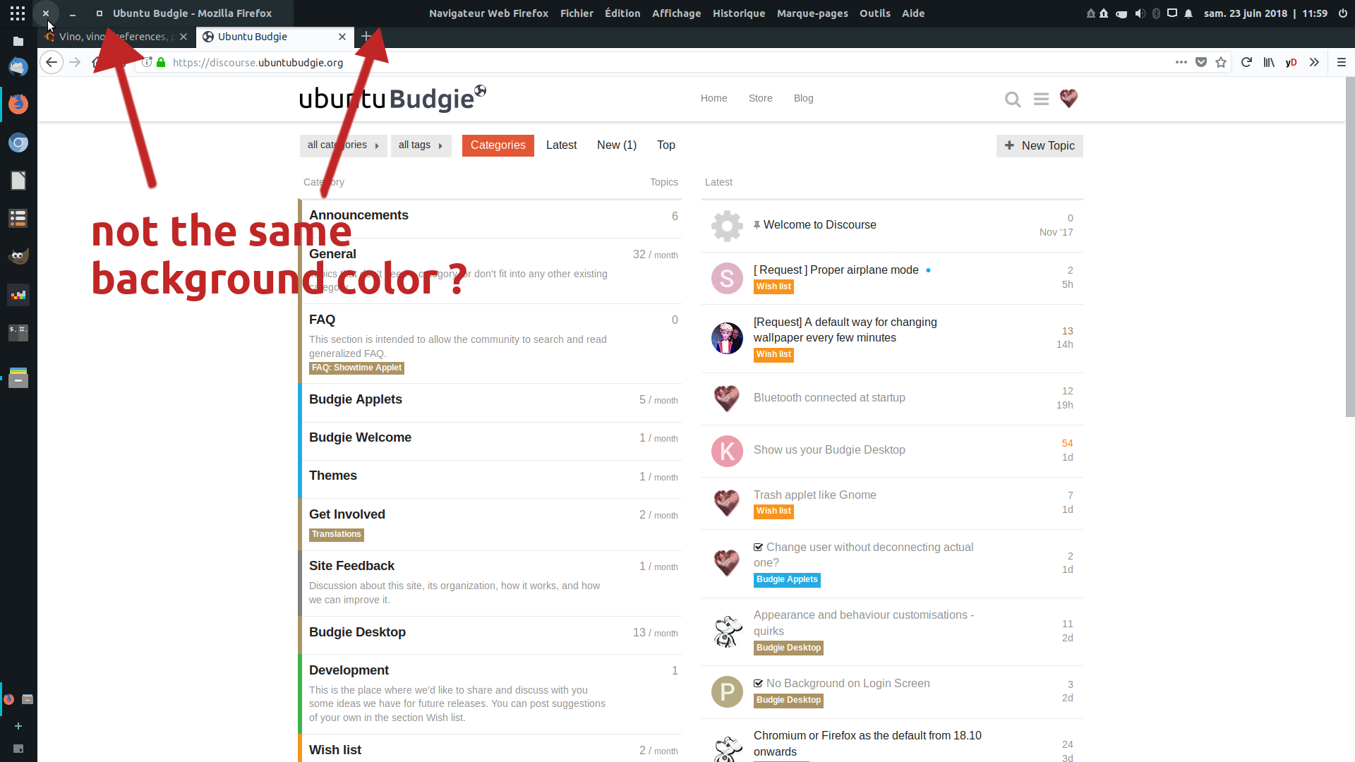

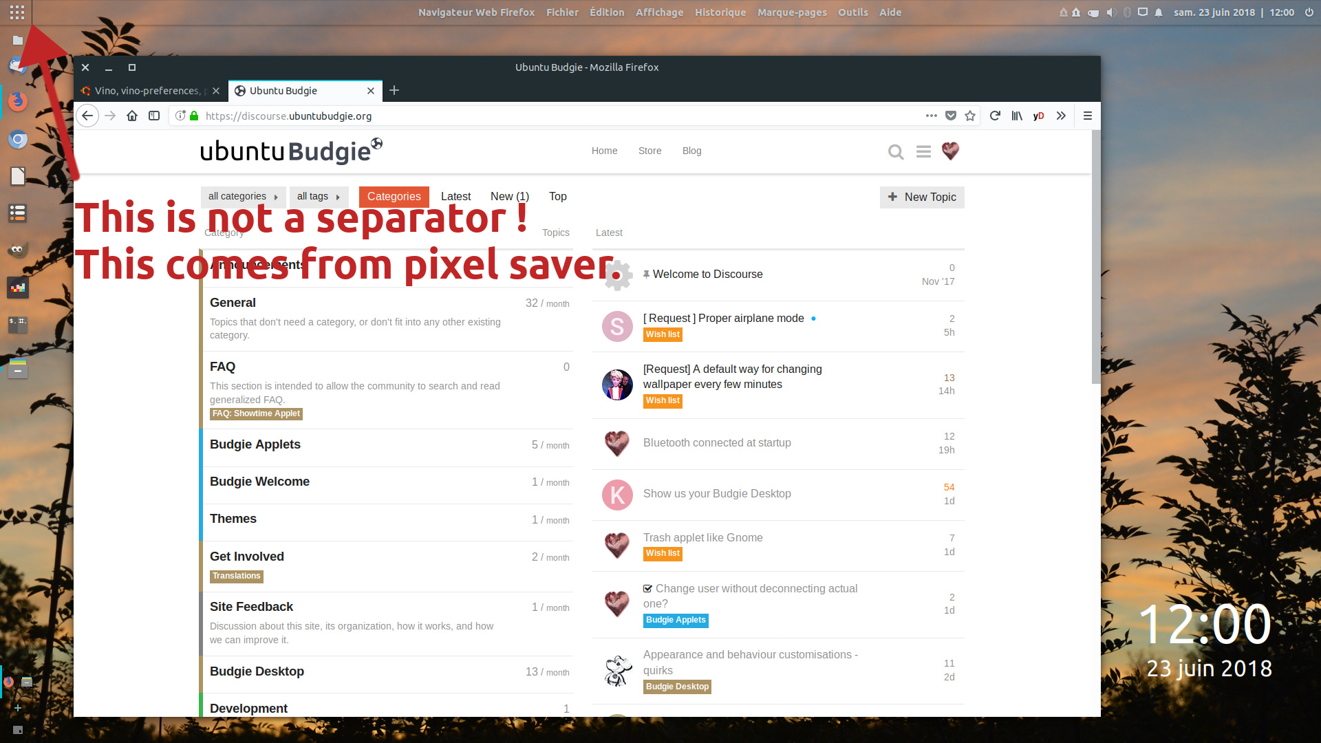

It seems that pixel-saver applet has some glitches in any theme - except Pocillo where it looks right
and here with Adapta it stays quite beautiful - but becomes really awful with Arc, Ambiance, radiance…
some pictures…
Ambiance and Radiance are just GTK themes - they do not have the additional budgie CSS theme styling.
For all other themes that have budgie CSS styling, some tweaks will need to be made to accommodate the pixel saver. If you can I would suggest fork the theme from GitLab/Github - make the change and submit the change back to the maintainer. If you cannot make the change yourself, then raise an issue with the maintainer - maybe the maintainer will find a bit of time to tweak hopefully.

And now that pixel-saver is at 4.0+git20210323-0ubuntu1~focal on my home computer, I get the same « wrong » behavior with styling in Adapta.
At least we have a culprit.
So this is with :
I’d expect something more like :
Here is Firefox, but same happens with Gimp, LibreOffice or Nemo.
And I can also confirm it’s pixel-saver / without theme styling styling which forces to have at least a 42px top panel. It’s very noticeable with « highlighted » tabs of Firefox or Thunderbird.
