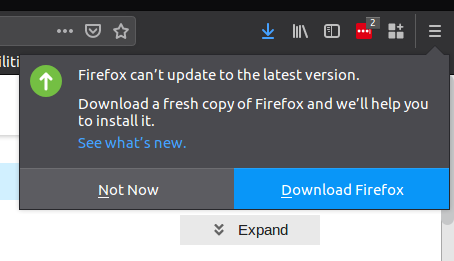

Every so often, Firefox shows me this message:
ff%201
My first question: Isn’t the Software system utility supposed to take care of this automatically? Is it truly necessary for me to download/install an entirely new version of FF to update it?

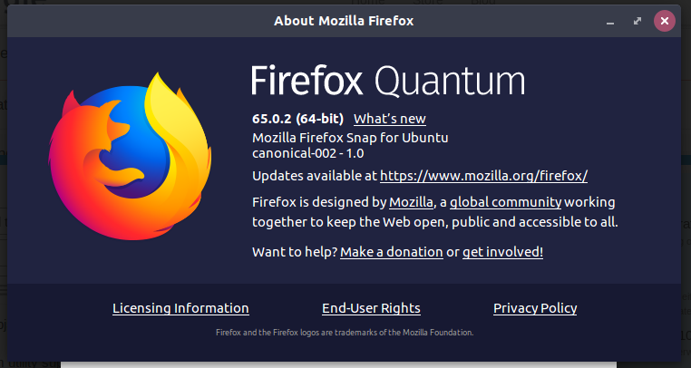

But let’s set that question aside for a moment. What does Firefox say my current version is? Answer: 65.0.2

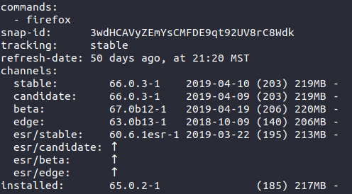

Well, let’s see what happens when I ask snap info firefox :
ff%203
Answer: 65.0.2. It appears even my system can’t agree with itself.

  1. Firefox says I have 65.0.2

Hmm. Your refresh date is very old.
Run
sudo apt update && sudo apt -y dist-upgrade
This will fully update your package management.
Reboot.
Then run
snap refresh
This should force snapd to update all snaps. Maybe it is a bit stuck and needs a bit of help!

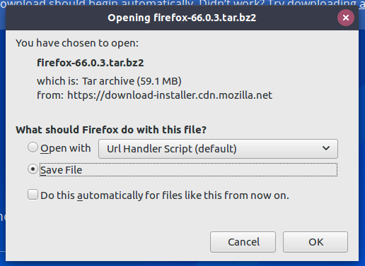

.tar.bz2 are source files. You usually need to compile source code .
Really only do this if you have a wet weekend to spare …
Yes, sir, that did the job, thank you very much.

Yes, I began to have that realization as I started researching how to install .tar.bz2 files. I thought to myself, “this is just a simple upgrate of FF from 65 to 66. Why should it require all this work?”
. . . which raised another question in my mind: Why would FF dump a non-compiled pile of source code on users, just to upgrade? Why would they not provide a self-installing, pre-compiled package – you know, just download, double-click and you’re done? Yet FF did not appear to provide any alternative to an uncompiled version. Seems very much on the not-user/newbie-friendly end of the spectrum.

Why would FF dump a non-compiled pile of source code on users, just to upgrade ? → it’s not.
Once extracted from the .tar.bz2, you get a folder containing a full working version of Firefox.
But you’re not expected to install a software this way under Ubuntu, since there are dozens of thousands already available app’s in official repositories.
