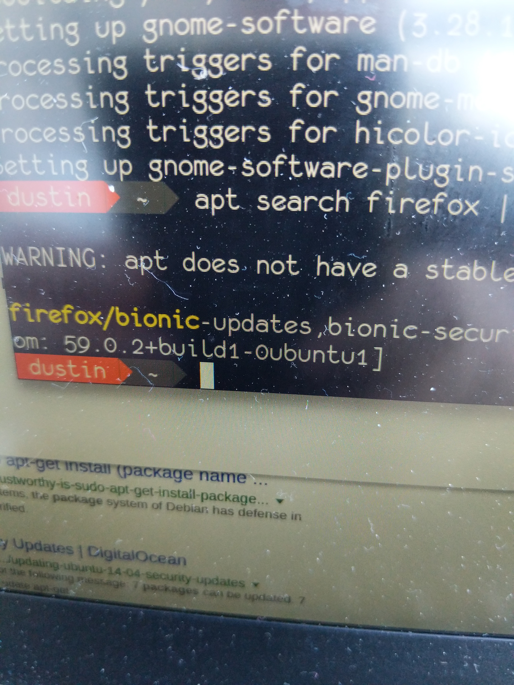

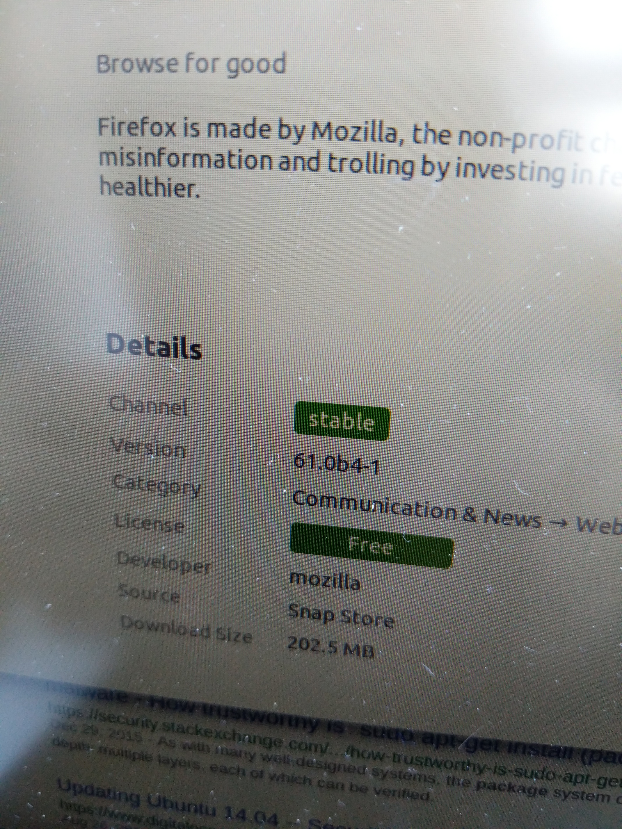

I know what the problem is! I had to reinstall gnome software to figure it out. In Nome software when you search, the version that is labeled as 61… Is a snap package whereas via apt and the traditional ppas, that is version 59. So how did you install the package? Did you install it via the command line with apt?15260914421364278512437367530145

Installed it via Software package manager that comes with the OS (the little white dots in blue background icon). Tried to take a screenshot but it did not work.

So it looks like gnome software may have access to the other snap channels - but that is odd to me. Looks like a gnome-software issue. Looks like it is pulling the version number from the beta channel.
