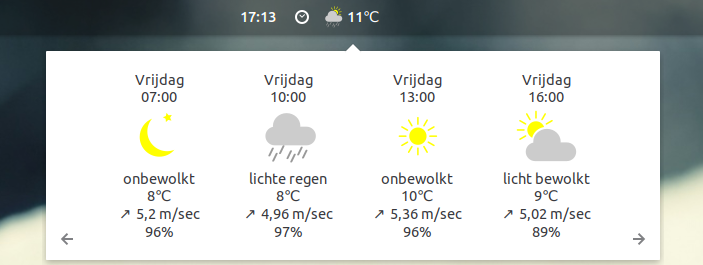

@makitso We are talking about this one:
afbeelding
right?
Yeah, was discussed before, but it doesn’t seem to make sense in a linear forecast in a time range.
No, this one
That’ s the one, but the new version looks slightly different.

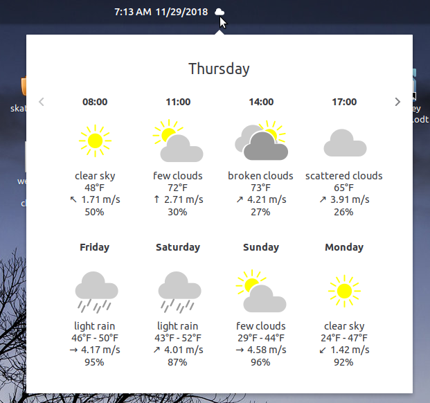

Created the solution by using OWM’s city list’s lon/lat info, to fetch corresponding state info. The new list, with state info, will be available soon.
afbeelding
Bravo to the solution and the effort you made. Thank you so much for me and all the others who enjoy U-Budgie!
