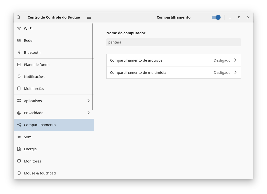

That could be an option, if somebody here can explain me how to activate the inbuilt VNC server.
Because when I open the Budgie Control Center, the only options that appear to me in the Sharing tab are theses:
No desktop or screen sharing available. And even with the sharing activated (i.e. the switch at the top of the window). there is no VNC server running in the machine.
The inbuilt VNC support for 24.04 was withdrawn from budgie-control-center because GNOME devs changed “gnome-remote-desktop” to only support GNOME Shell.
We have a script though available that we developed for our raspi image to enable a budgie-desktop to remote onto the raspi. It does work for desktop to desktop as well.
This uses x11vnc - so I would uninstall tigervnc and install x11vnc
Then (assuming you have budgie-arm-environment installed) run
/usr/lib/budgie-desktop/arm/scripts/budgie-vnc.sh setup password
run /usr/lib/budgie-desktop/arm/scripts/budgie-vnc.sh for the various options available to control access
This will initialise x11vnc with a password of “password”
Connect with remmina using vnc.
In the same folder there is a budgie-xrdp.sh script - so you could use xrdp instead and connect via RDP.
Hope that helps
