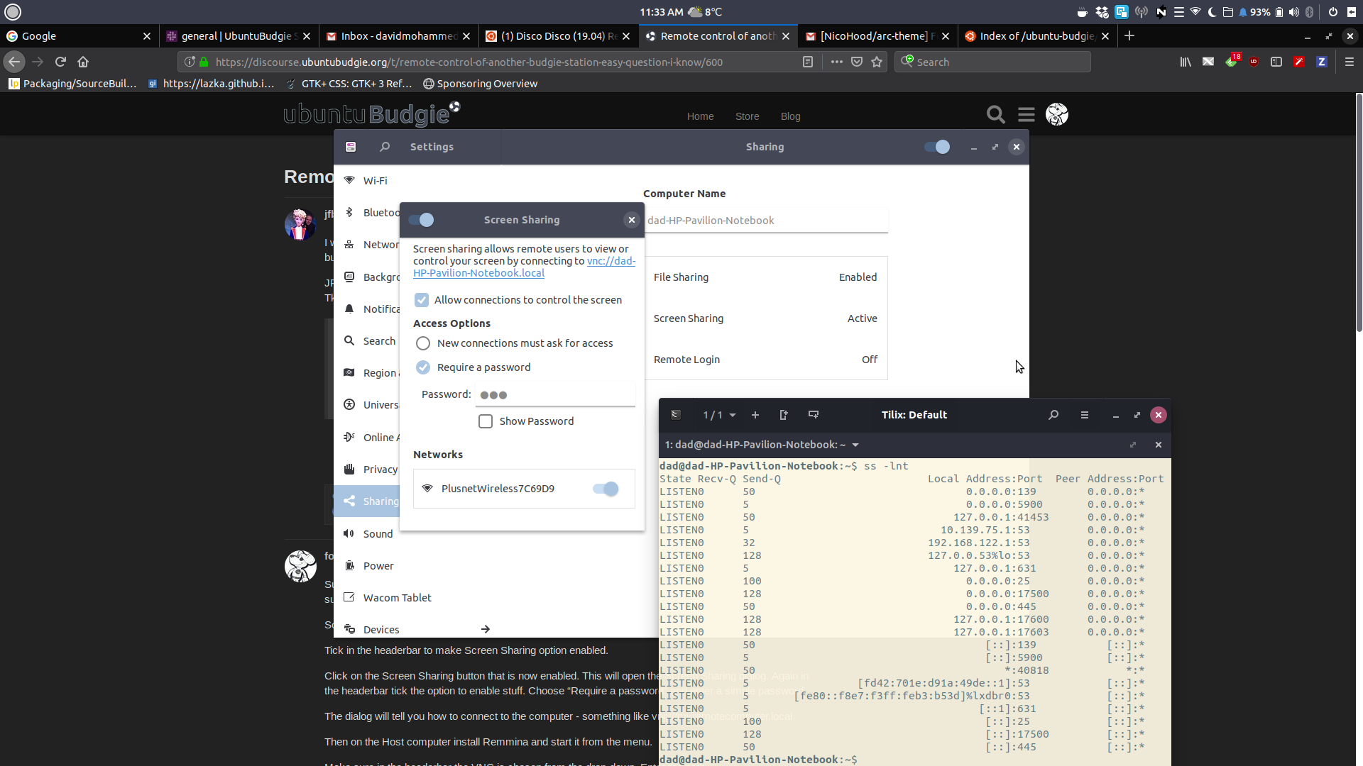

Workspace%201_008
I’ve set my sharing options as shown - note that ss -lnt returns info indicating that the daemon is running. Please check that you have the switches enabled as shown - especially the top left switch in the dialog
A lot of thanks. After I see your image,I understood that something strange was happening, so I restarted, and after the restart the demon was already shown in the listening, and the error messages in connection attempts were other.

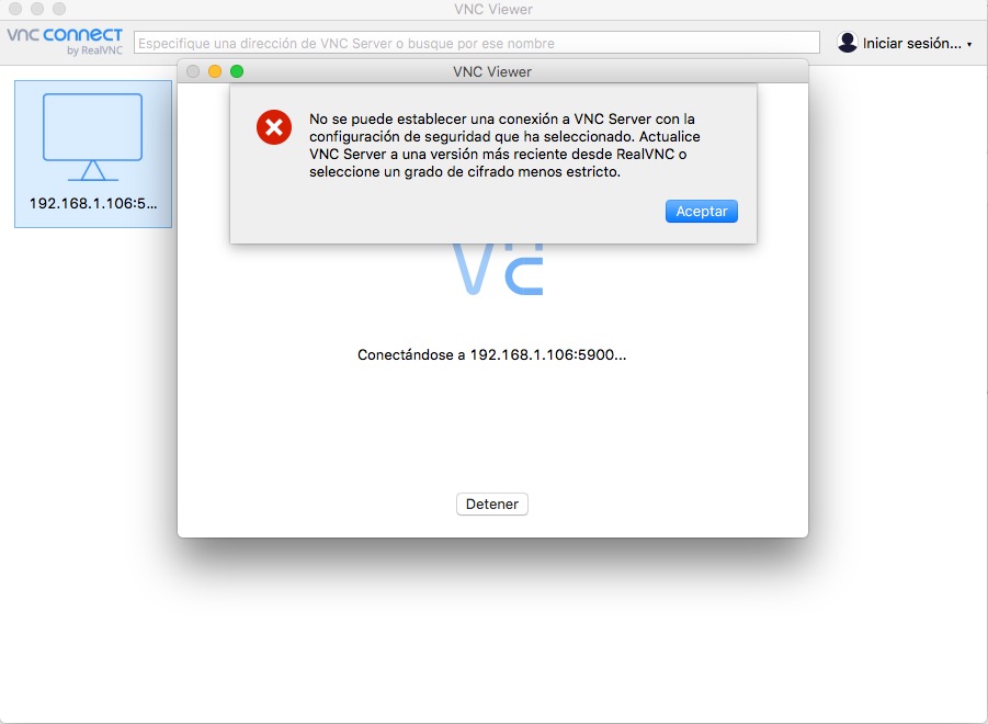

  • With VNC Viewer, problem about configuration of security, instead if deactivate security in VNC Viewer.
  • VNC_Viewer_y_VNC_Viewer_y_VNC_Viewer_y_Traductor_de_Google
I think you have to disable encryption:
gsettings set org.gnome.Vino require-encryption false
Hi.
A lot of thanks…
With this settings work with VNC Viewer, TigerVNC…
Best regards. (Baraka Allah fik)
