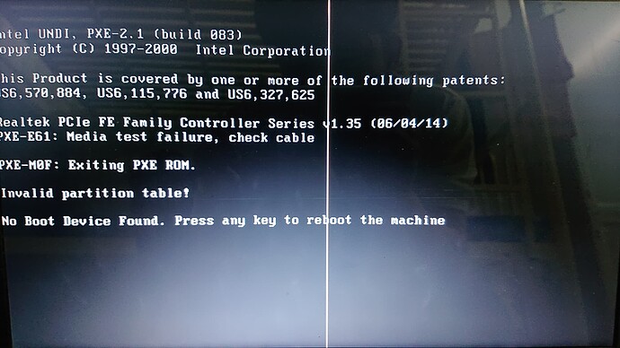

Error when install Ubuntu on laptop Dell 15 5558
Uploading: DSC_0213.JPG…
Help me, pls. I dont know what happen with my laptop when i install Ubuntu.
Please reupload the image since it hasn’t appeared in your post.
I have installed ubuntu before, but when I reboot, I get the same error. I have reinstalled it but it still error.
Pls help me. I am text by ubuntu with usb.
this is my ssd, where i install ubuntu.
Please have a good read of the following - it really depends on what options you chose when installing.
For example if you have multiple drives - did you install ubuntu on a secondary drive and also installed the boot part on the secondary drive - is should have been the primary.
There could be other issues as well - the topic I’ve linked to below explains the common issues.
Obviously the windows referrals in the topic means you need to apply your image backup which I’m sure you did before installing.
Is it possible that the hard drive lost the boot file?
Because i only have two hard drives, one ssd and hdd and i install on ssd. Boot order is also in order: first is s
sd hard drive.

(3) The SSD is in the laptop. You installed Ubuntu Budgie on the SSD. The SSD does not boot. The error reported is “Invalid partition table!”

I am not 100% sure why you are getting the “Invalid partition table!” error. Several things could be causing the error. The most likely reasons are (a) the boot partition was not properly set up, or (b) the MBR partition table is corrupted.
I think that your best option at this point is to rebuild the SSD from the ground up, starting with setting BIOS to modern UEFI standards and installing a “clean” (that is “wipe the entire drive and install Ubuntu Budgie as your only operating system”) installation pf Ubuntu Budgie on the computer.
