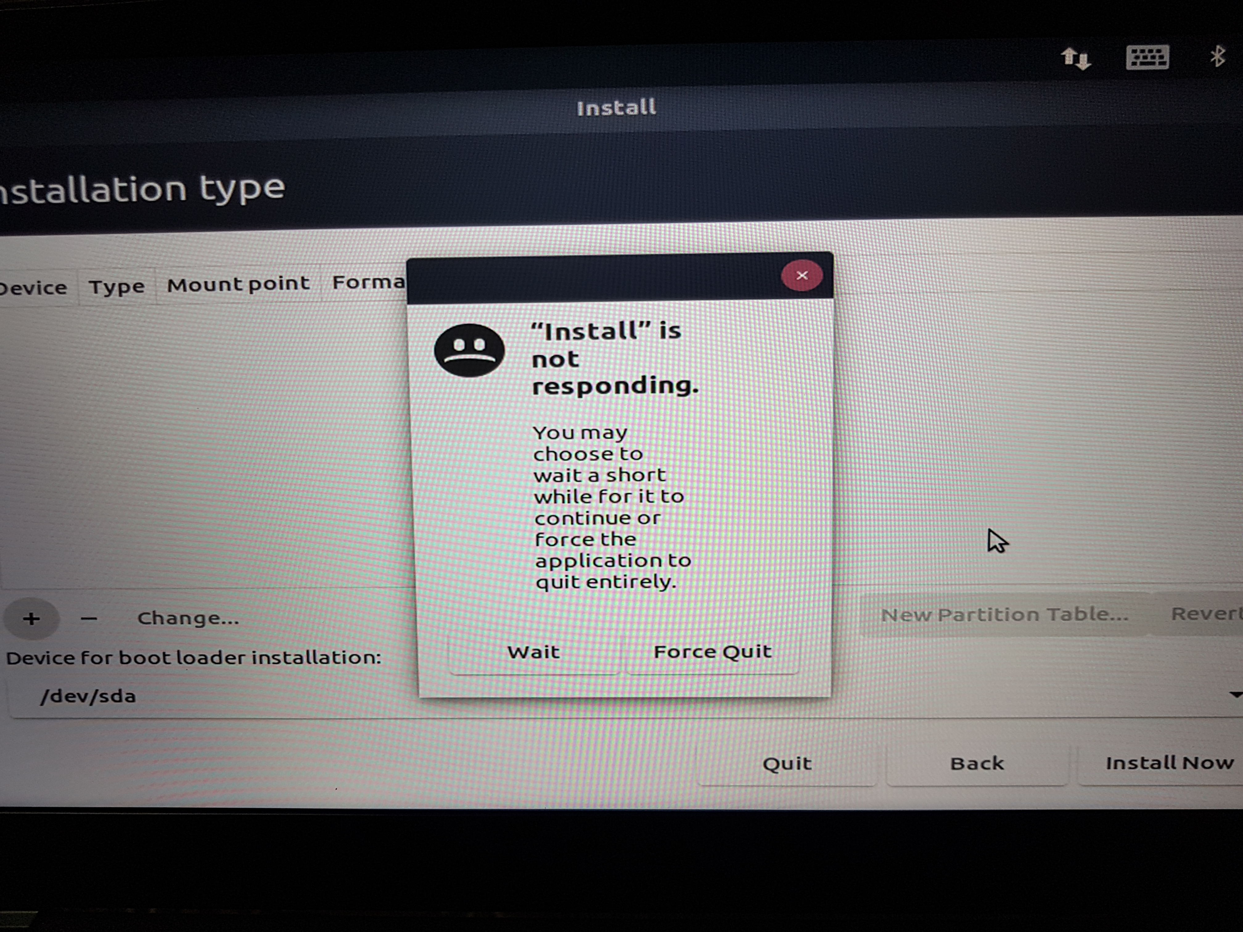

The problem is, I get stuck at the Hard Disk Partition. None of the partitions display and if i press any button, it stops responding.
Now, after trying your solution, it doesn’t freeze anymore but instead it just quits the installation20190226_170730

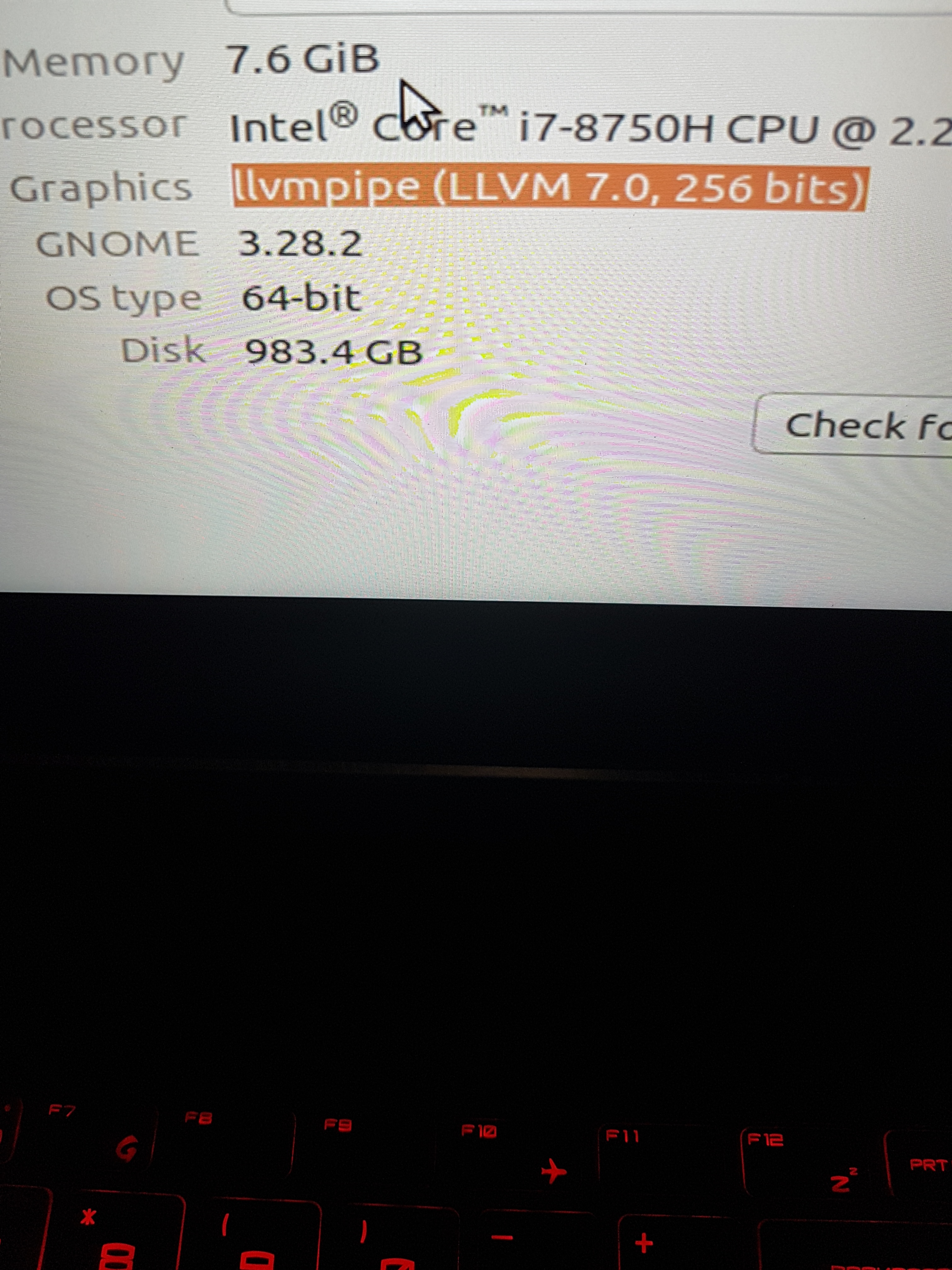

My problem now is intel rapid storage technology RST. I had to switch to AHCI so that ubuntu can detect the hard drive volumes… Is there anyway i can use RST with ubuntu? I’ve deleted windows and installed ubuntu on my HDD, so intel optane memory is useless now…
Also, after trying nomodeset, the resolution’s terrible now and I’ve tried to use terminal to get the graphics drivers, didn’t work

For the drivers run
software-properties-gtk
Click on the additional drivers tab and install the nvidia driver that is offered to you. Then you dont need to use nomodeset
