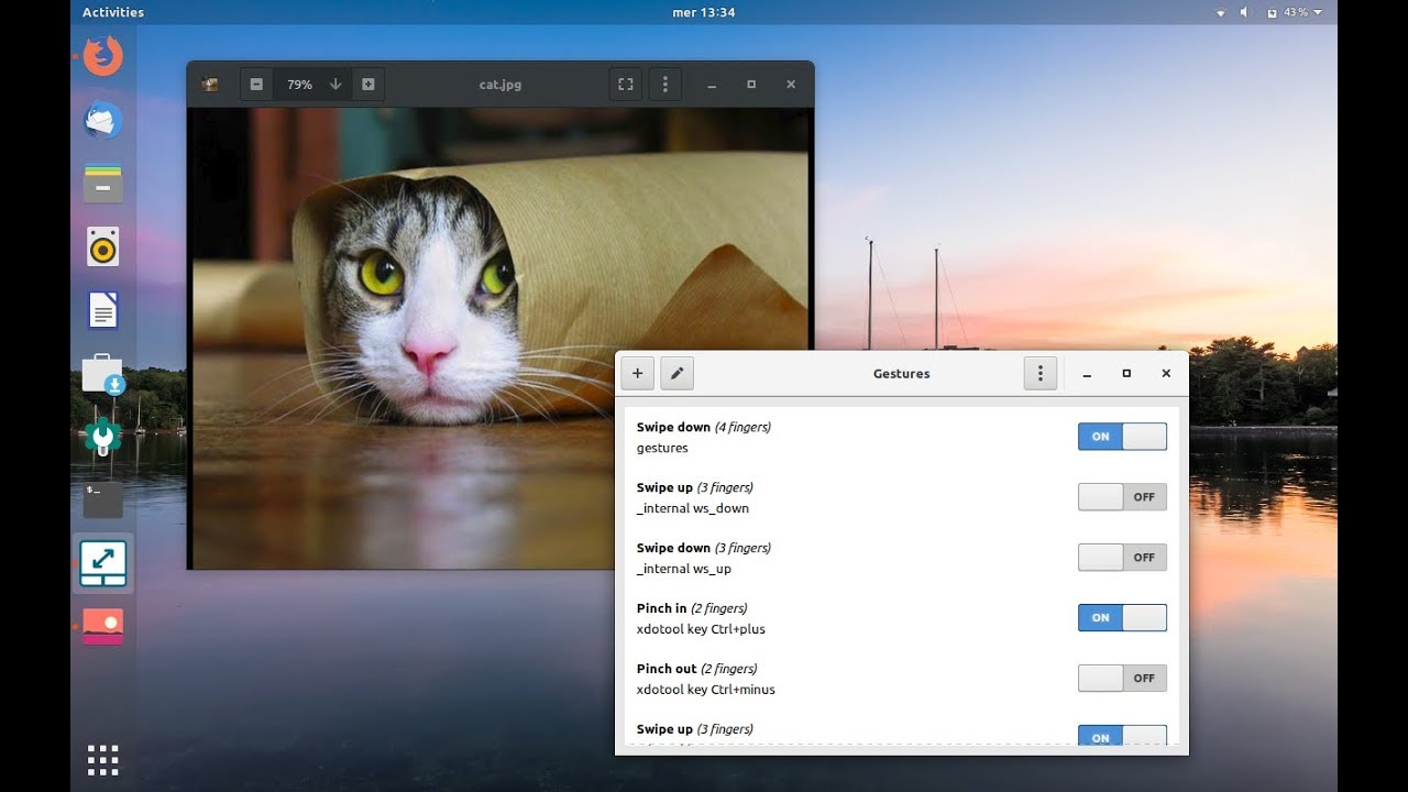

Looks like someone already wrote a GUI for libinput-gestures, but either needs to be compiled or installed via flatpak, so I installed flatpak, but apparently will need to reboot before I can use it. Probably means that I will be opting to compile it instead as far as kairos is concerned.

I’ve looked at that before. It is missing some key capabilities - like
a. ability to test if the gesture works
b. confirming compatibility with cheap and cheerful touchpads that can’t manage more than one touch.
Ah, well I have a pretty cheap chinese macbook clone and an old x220 thinkpad, I can test on those later (correction I know it works on the macbook clone, x220 I don’t yet know). Surprisingly the macbook clone I have does pretty well with multitouch despite people and reviewers saying it didn’t have multitouch.
Also it appeared like, at least in the version I just installed, flatpak, that you can click the finger swipe itself and that will activate the command you had typed into the box. Also whether you install via flatpak or not, I think the libinput-gesture app requires users to log off and back on after being granted permission to access inputs. That may confuse first time users installing it and make them think it is not working.

Update: I’ve submitted an issue ticket to him requesting he adds predefined actions per desktop environment, if nothing else I may fork his project and add predefined actions myself and submit a PR later. It looks to be written in python so I would have some ease with it already.
I guess I should mention that on the 3 finger swipe left I use this.
xdotool set_desktop --relative -- -1
and to the right I use
xdotool set_desktop --relative 1
This appears to work for me when _internal ws_up or down does not.
Would be a lot nicer if the Gestures app had preset default actions - instead of just a custom field imo.
