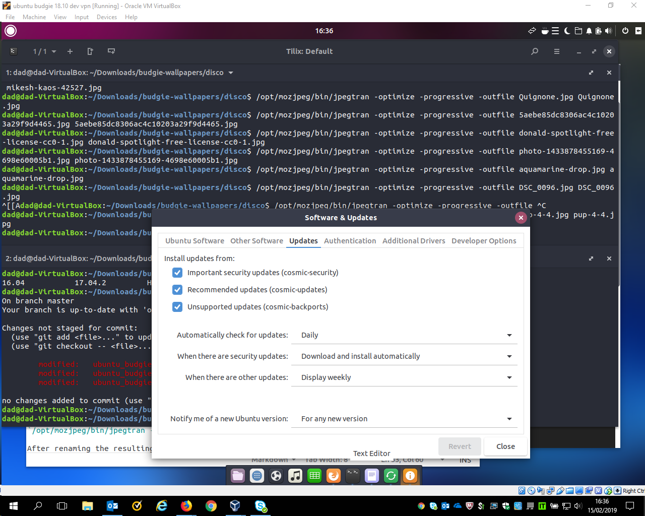

Do check that in Software Updater - Settings the automatically check is not set to Never
see my VM settings here and that the update icon has automatically appeared in plank
My setting was set to Check Daily & Display Immediately for the next two options.
Never was not selected. So, for the time being, I’ve changed by settings to be the same as yours.
