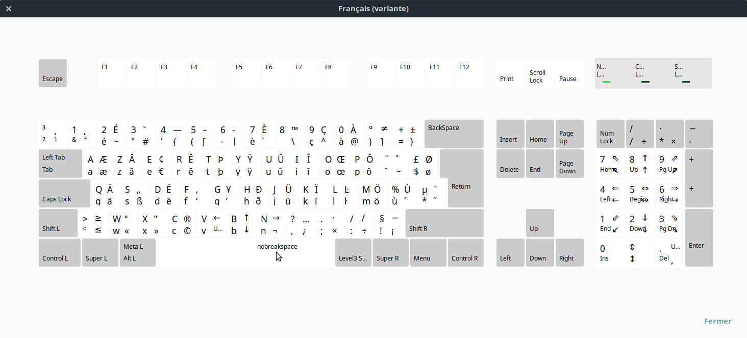

l’illustration date un peu mais ça reste le même principe ↑

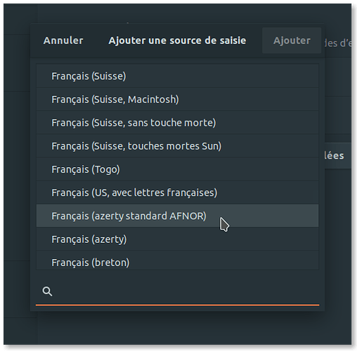

exemples de choix d’agencements clavier pour le français ↑
l’agencement français ( variante ) ↑

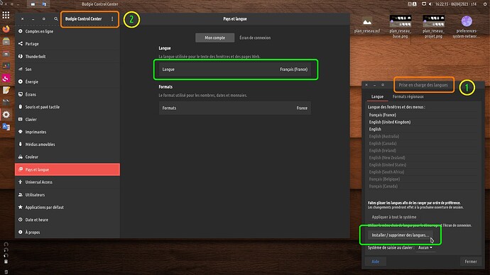

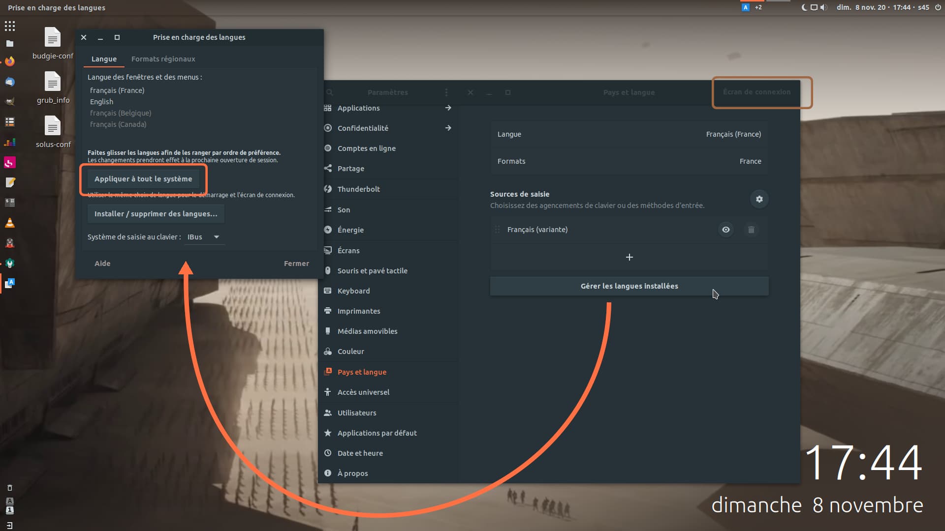

For language and keyboard settings, there are 3 steps.
First step is to open « Prise en charge des Langues » which you will find in your applications menu. It’s not « Paramètres / Settings / Budgie Control Center ».
There you add your desired language(s), and you apply to whole system.
This will provide languages and keyboard mappings for all other applications.
Maybe « Système de saisie au clavier » should be IBUS by default instead of « Aucun / none » ?

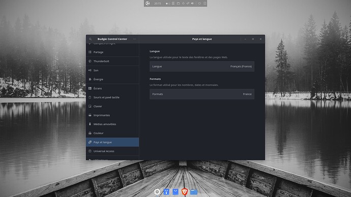

Then a second step is to open Budgie Control Center, and check in « Pays et Langues » if « Langue » and « Formats » are set accordingly. For your personal account AND the login screen.
It’s often here that the settings are not copied from what you chose during installation or through « Prise en charge des langues ».

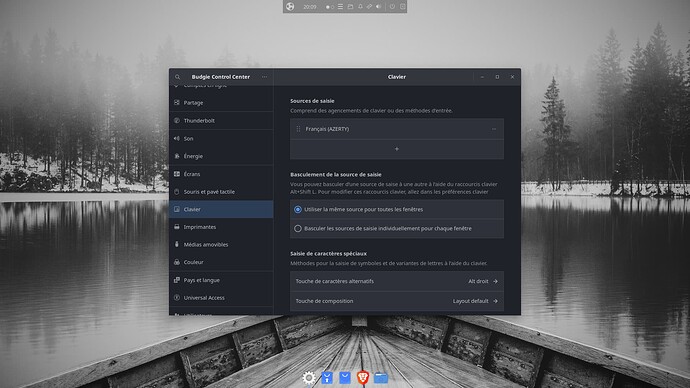

And third final step is still in Budgie Control center to go to « Clavier » and here set your desired keyboard mapping ( agencement ), Français ( Variante ) or Français ( afnor ) or anything else that fits for you.
