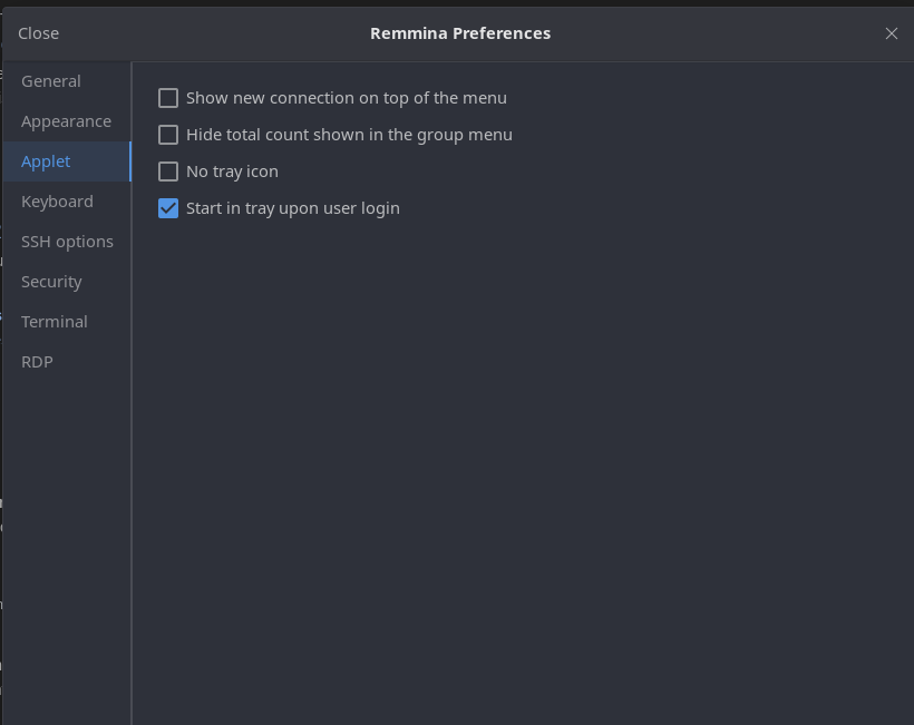

i recently switched to Ubuntu Budgie after previously using standard Ubuntu. I like Budgie very much, but i have the following problem: When i close the Remmina window, it does not open again when i start it up. Only when i close the process i can start Remmina up again. However, if i enable “dont show symbol in notification field” (under settings > applet) the app can be opened and closed without closing the process. The symbol also does not show up (prior to disabling it) in the task bar, like it did in my previous Ubuntu installation. Is there a way to fix this?

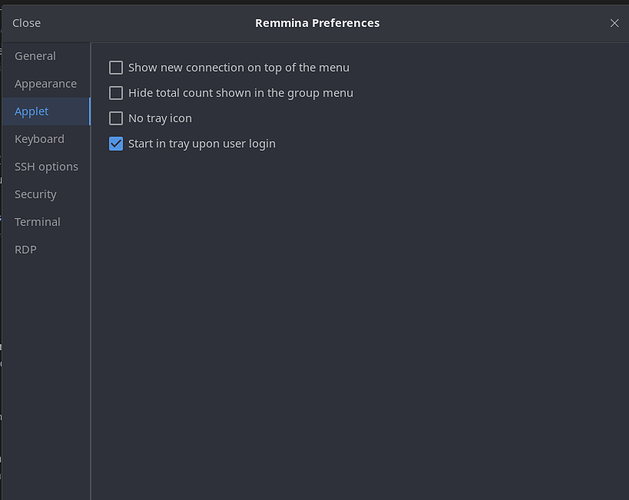

its “no tray icon” sorry for the confusion, but my system is in german

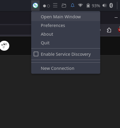

i dont see the tray icon, even when its enabled. so i can only reopen remmina, if i close the process.

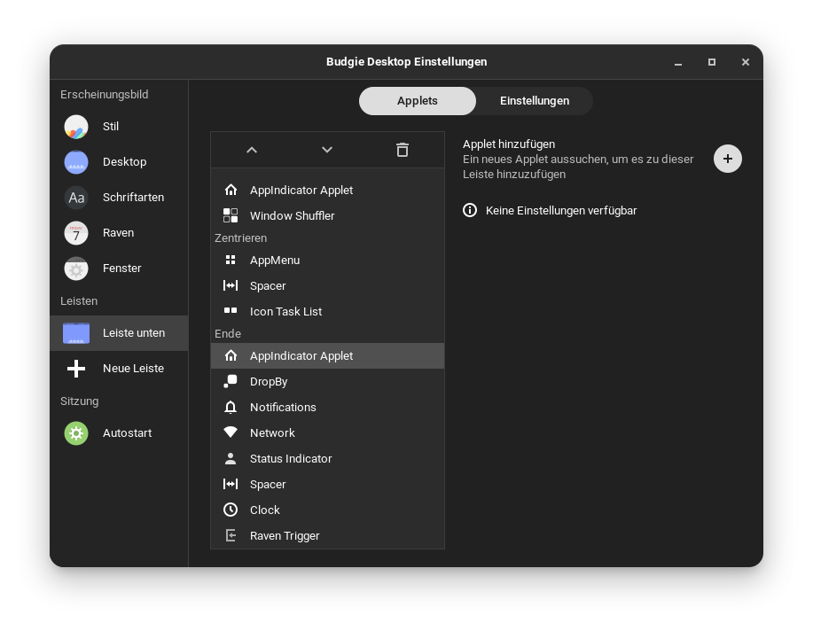

Have you got the AppIndicator applet on your panel?
you have two AppIndicator Applets on your panel. Remove one and reboot.
i removed one and enabled the tray icon + reboot, its still not showing
Are there any appindicators being displayed?
