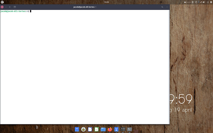

Works perfectly here…
Could you try to log out/in?
