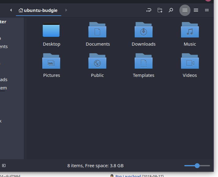

The icons seems to be somewhat small at 50%, maybe that can be corrected by adding libexempi3_2.4.1-1 from here, at least that worked for me.

Have you added backports? If you have you would be running nemo v4 since we are recommending that version for brave souls.
EDIT 2: I install the libexemp3 library from debian, killed nemo v3 and restarted - I didn’t notice any differences in the icon sizes.
I am using Nemo v4.

The small icon issue is with our backports version? I hope you didnt install a linux mint package version since that will cause issues just like this.

You have a hybrid install. We cannot support such a setup since stuff may not reflect reality. Does your date issue occur on a live session UB iso?

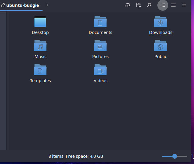

Downloaded the daily few minutes ago,
Icons in Nemo at 50% (default size)
Installed Nemo 4.0.6 from Budgie backports and added libexempi3_2.4.1-1 deb package through dpkg -i and,
the size of the icons became bigger. Looks also nicer without that distance between them. Done this on a Live session. Just put Nemo out and opened back again.

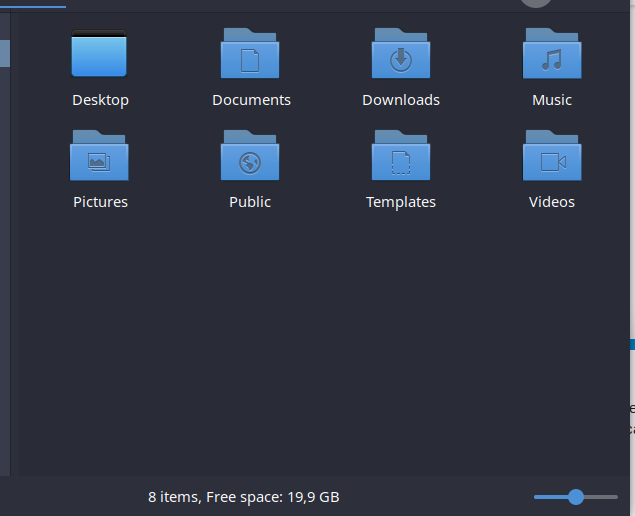

Installed today’s UB on bare metal. Nemo icons are as in the post above.
