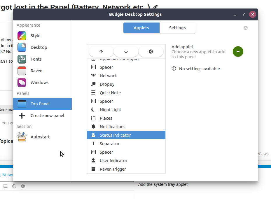

Some of my Applets in the Main Panel got lost and I cant figure out how to add these again (Battery & Wifi).
When Im in the Budgie Desktop Settings and want to add them, theres no Applet like that. AppIndicator Applets? No settings available…
How can I solve this Issue?
Add the status indicator applet for the Battery.
Add the system tray applet for Wifi
Budgie%20Desktop%20Settings_106
