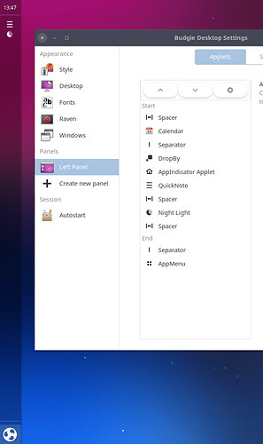

When I remove Network from my layout file and reset, it looks like expected:

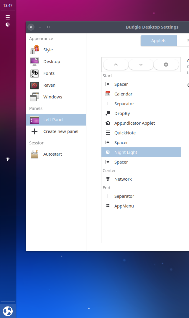

Now I add Network via Budgie Desktop Settings, it automatically appears in Center:
Now I try to move it up, to make it sit below Night Light, what happens is unexpected:
In Budgie Desktop Settings it is shown under Start but on the panel itself, everything has shifted to Center. This is not suppose to happen and I can’t solve it.
This is 20.04. I don’t seem to have this issue on 19.10.
That’s a bug with the network applet that is fixed in v1.0.2 - this version I am waiting on Canonical to approve before its uploaded to 20.04
