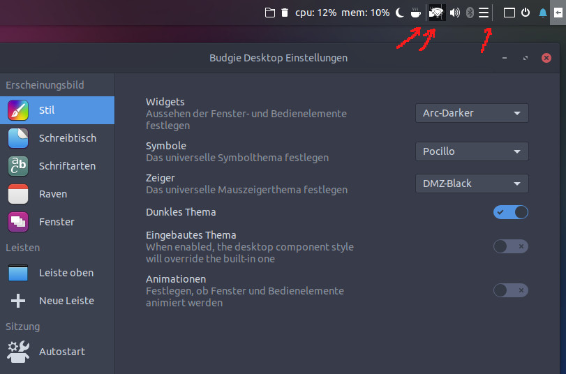

Budgie-core updated budgie-theme (Pocillio,…) yesterday.
After reboot the network icon is black and the spacers are white instead of dark color.
Network icon stays black when changing theme settings.
Screenshot:

That does occasionally occur after first logon. That is because of the very buggy system tray applet.
Restarting the panel resolves this when it happens … or moving the panel from top to bottom and back again via budgie settings.
nohup budgie-panel --replace  &
I personally dont use the system tray applet I have removed it.
I have installed the applet budgie-network-applet which installs a native network manager applet for budgie (you need our backports ppa for this)
Is there a way to fix this with keeping the system tray?Screenshot%20from%202019-11-12%2008%3A59%3A54
I personally dont use the system tray applet. I use the network applet from Menu-Budgie Applets to display network connectivity
