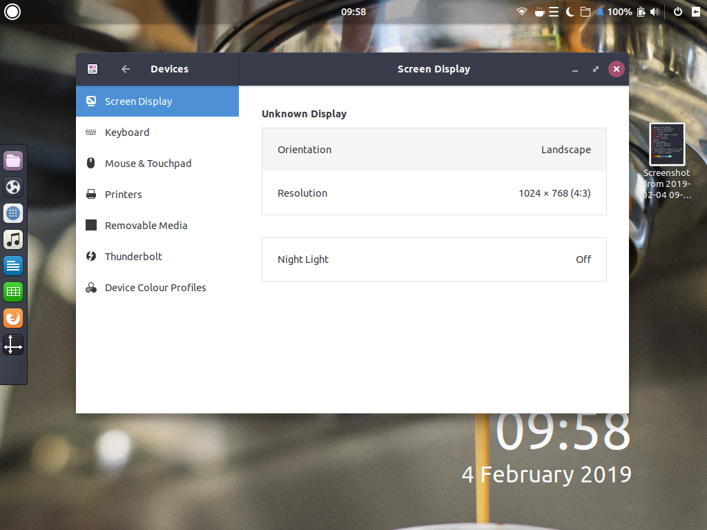

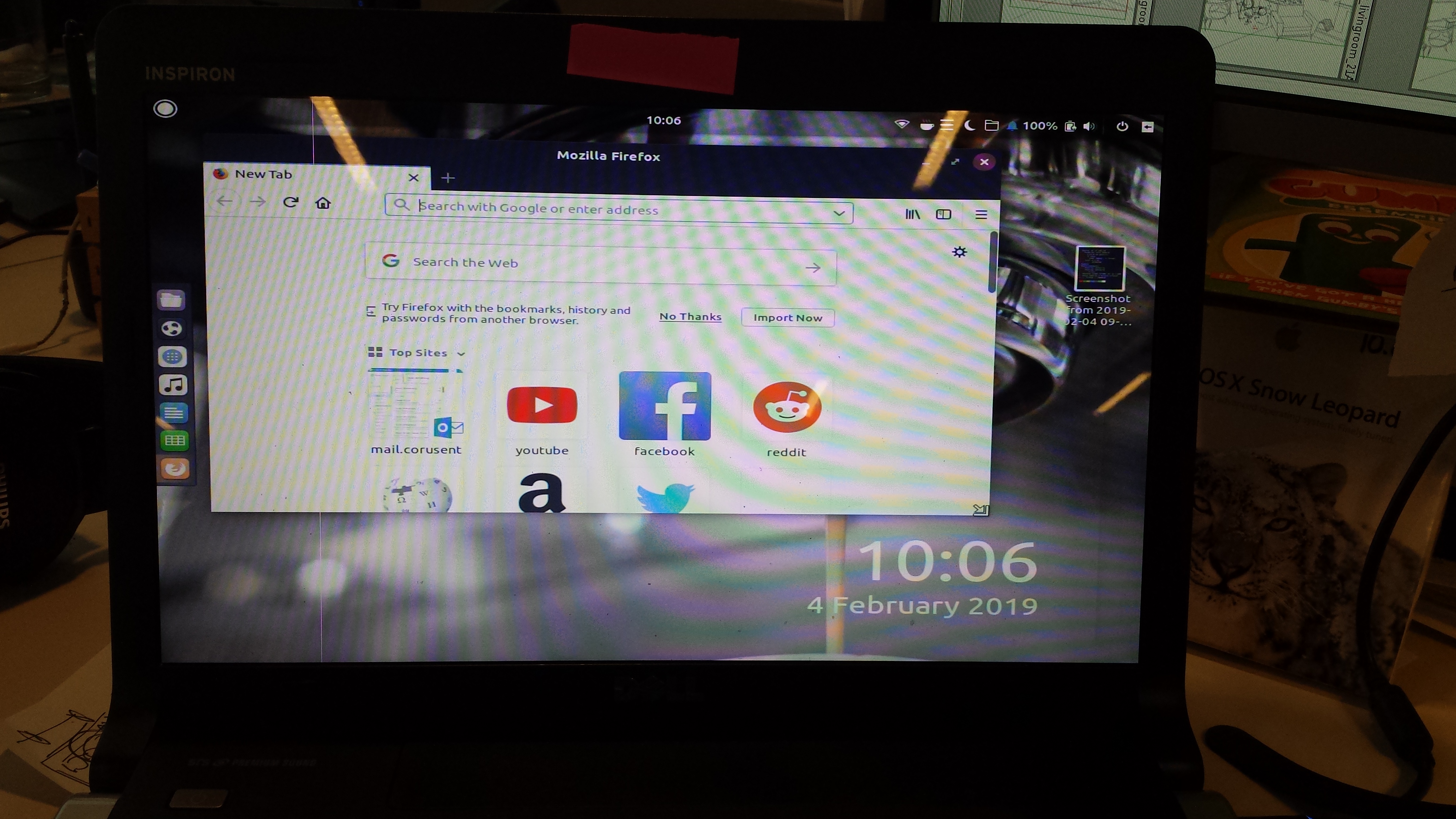

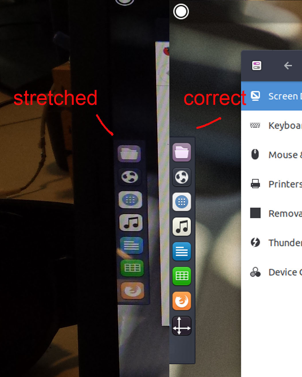

Hello! I updated my Ubntu Budgie 18.10 laptop, with the siftware updater this morning. I have a weirdly stretched desktop (top bar, plank, et.al) so I assume something has gone on with the screen resolution? My default for this dell laptop is 1024x768 (4:3)
I tried to figure it out, but then gave up and reinstalled from scratch (already have backups) Clean install is always nice but once I ran through the updates, it restarted with the same issue, so I conclude it’s something on the Budgie/Ubuntu end? help? I can provide screen shots or info as requested.

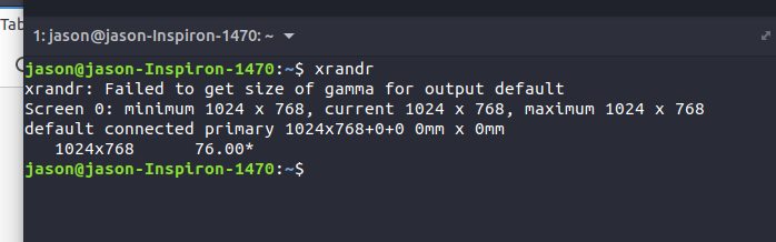

There was an update to the kernel a few hours ago (https://launchpad.net/ubuntu/+source/linux) - please can you boot with the older kernel listed in grub - advanced (press shift / press escape on reboot) to see if that makes a difference?
Please report the issue to launchpad to let the Canonical Developers know about the issue. They can advise further what to-do and hopefully will fix in a future kernel release
ubuntu-bug linux
In the report say which kernel version works … and obviously which kernel version doesnt work.
