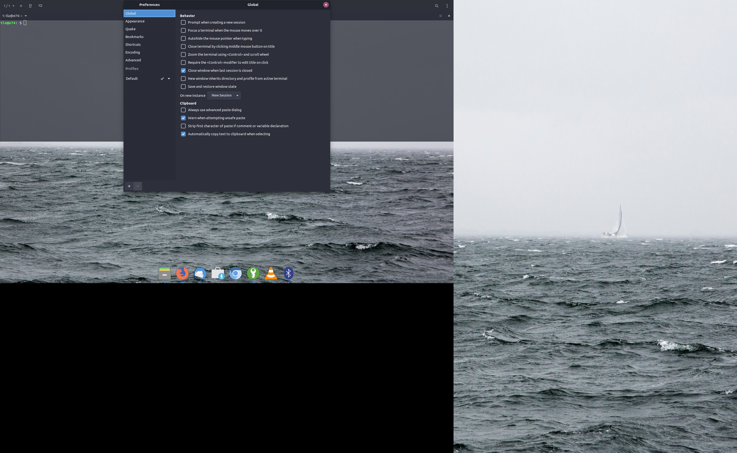

I have two screens next to each other and the right one is rotated to portrait. This seems to create a problem with window placement. If I open the Tilix preferences, the top of the window is placed outside the screen and I have to Alt+Space -> Move to grab it.
Screenshot_window-placement1
On the other screen, it’s fine. Is there a workaround for this? I’d be thankful for any pointers.

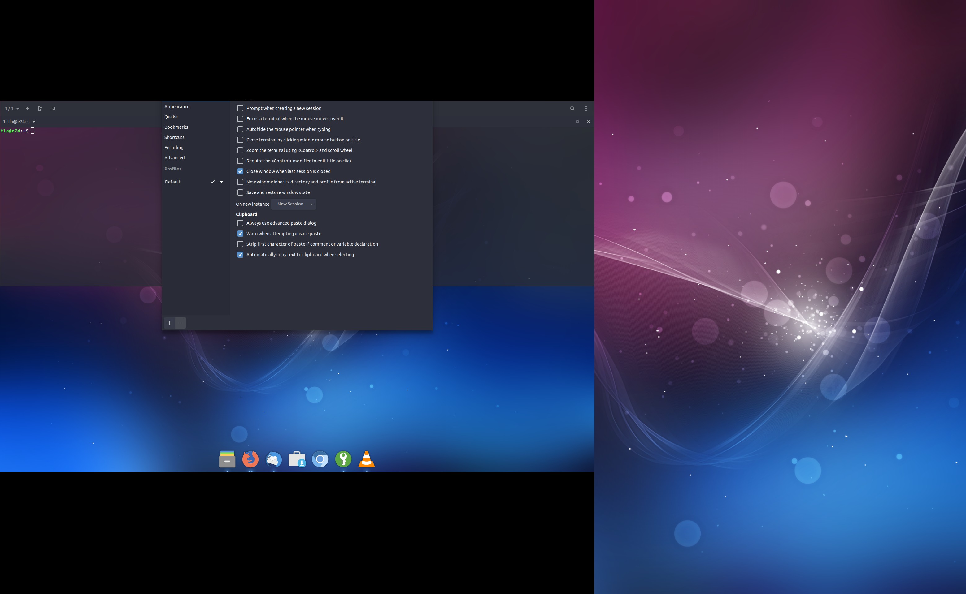

In settings - displays can you drag your second screen down so that the top of both Windows are parallel?
Thanks for your reply. I did and this indeed solves the problem. At the cost of not having the screens set up correctly. So I’d say this is a bug right?
Screenshot_Tilix_top
