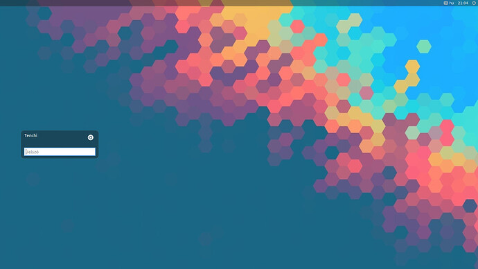

For GDM3 - what does your login manager look like? If it looks like this then you are using lightdm/slick greeter

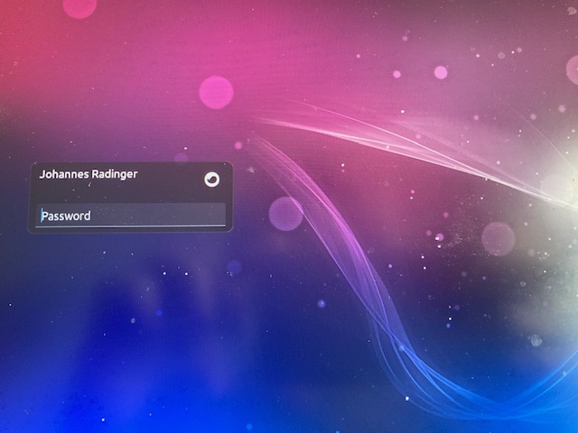

Thats how my screen looks at start up: IMG_3643

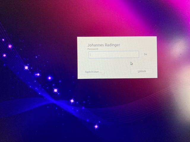

Now my lock screen after suspend is different from that after reboot…as shown in the picture IMG_3644.
Is that how it should be (i.e. to have different login screens after suspend and lock)?
Yep - that is how it is expected to be - that is “gnome-screensaver”
If you are using a theme like Pocillo - then it would be darker. The theming of gnome-screensaver is dependent upon the theme you have chosen for your desktop.

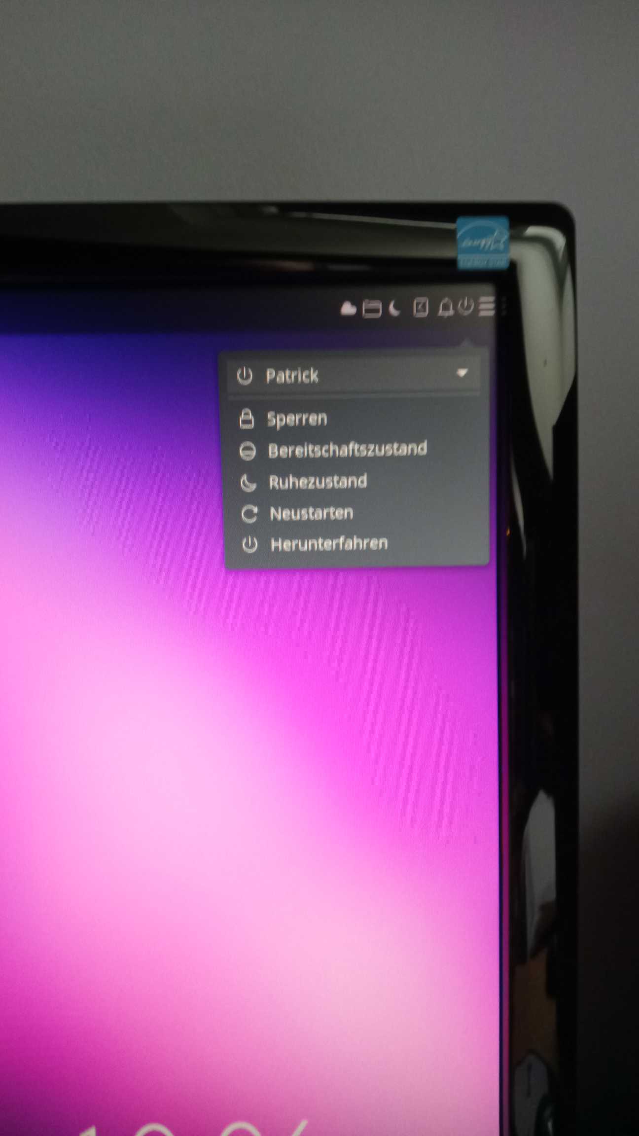

What are your display - lock options in Budgie-Control-Center - Displays ?

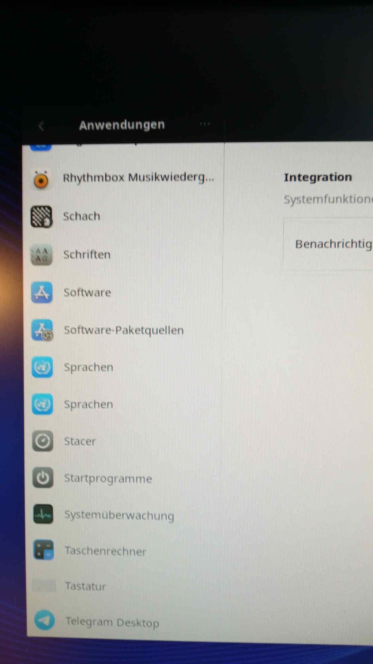

Hope you had a nice weekend. Actually I didn’t see any lock options (Sperren) in the Budgie-Control-Center-Displays. Maybe it’s just me being stupid again? Here are two pictures (screen shots) of my PC.

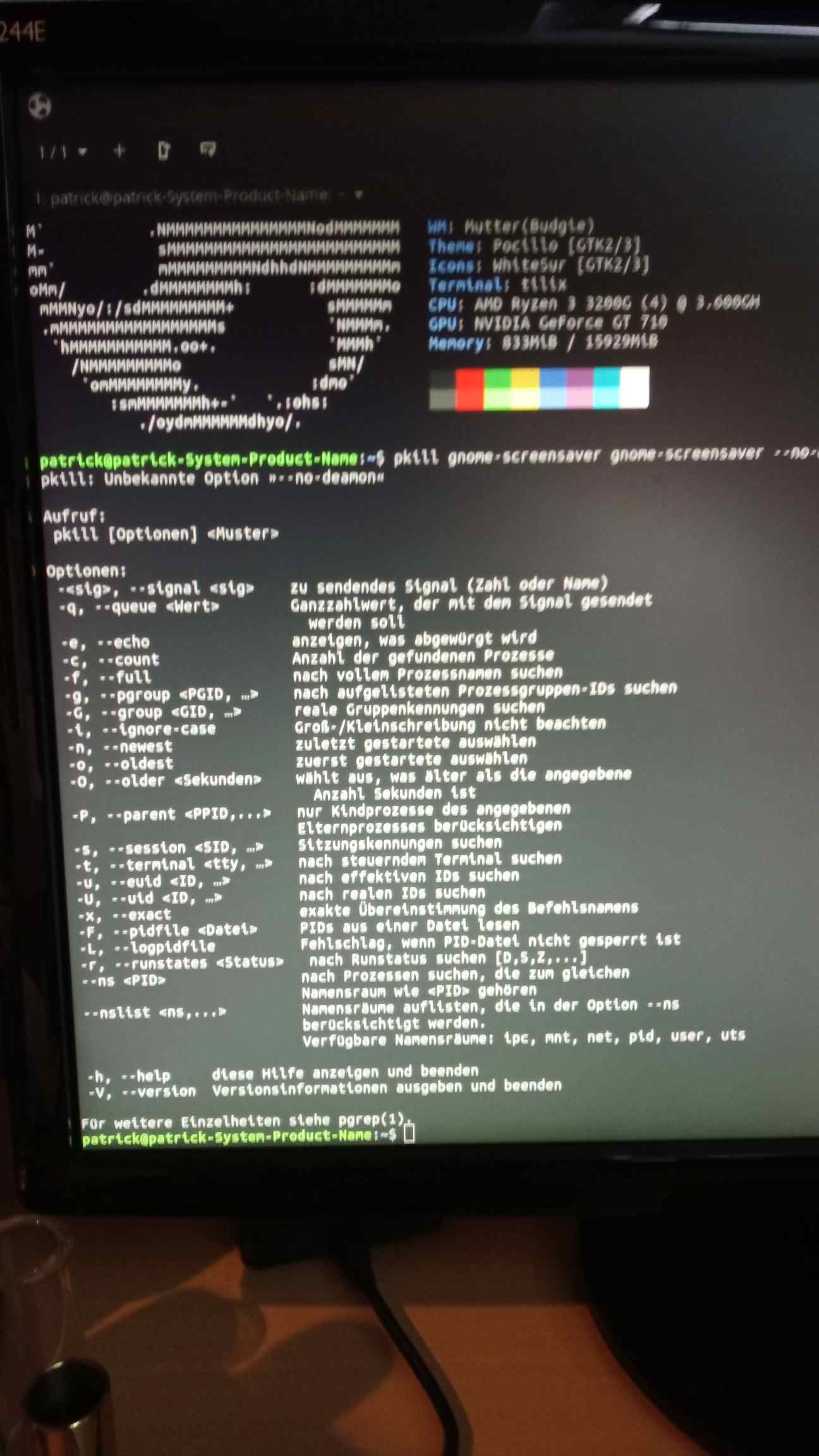

First of all… thank you for the suggestion. Here’s a photo of what came up on my Terminal.
pkill: Unknown Option >>–no–deamon<< (unknown would be the translation from German)
