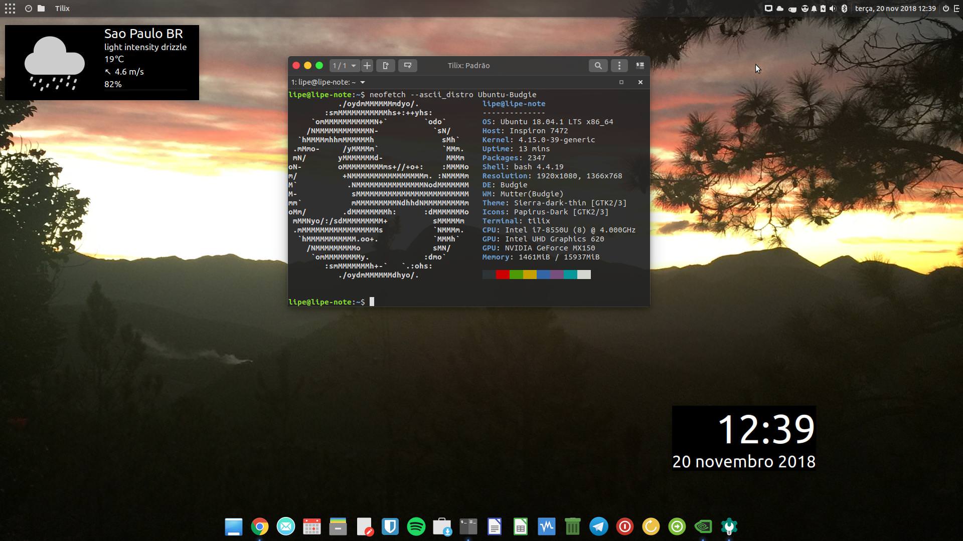

I am configuring my UbuntuBudgie 18.04 and would like to have ShowTime and WeatherShow on my main laptop screen.
When i add the Applets they look fine, but after a while or after I reboot their backgound turn black.
My Notebook is an Inspiron 7472 from Dell that i bought with Ubuntu Pre-installed. It comes with a Nvidia GPU (GeForce MX150) and I am using the nvidia drivers.
Any one knows how to fix this? I googled around and look at this forum but was unable to find something.
Thanks

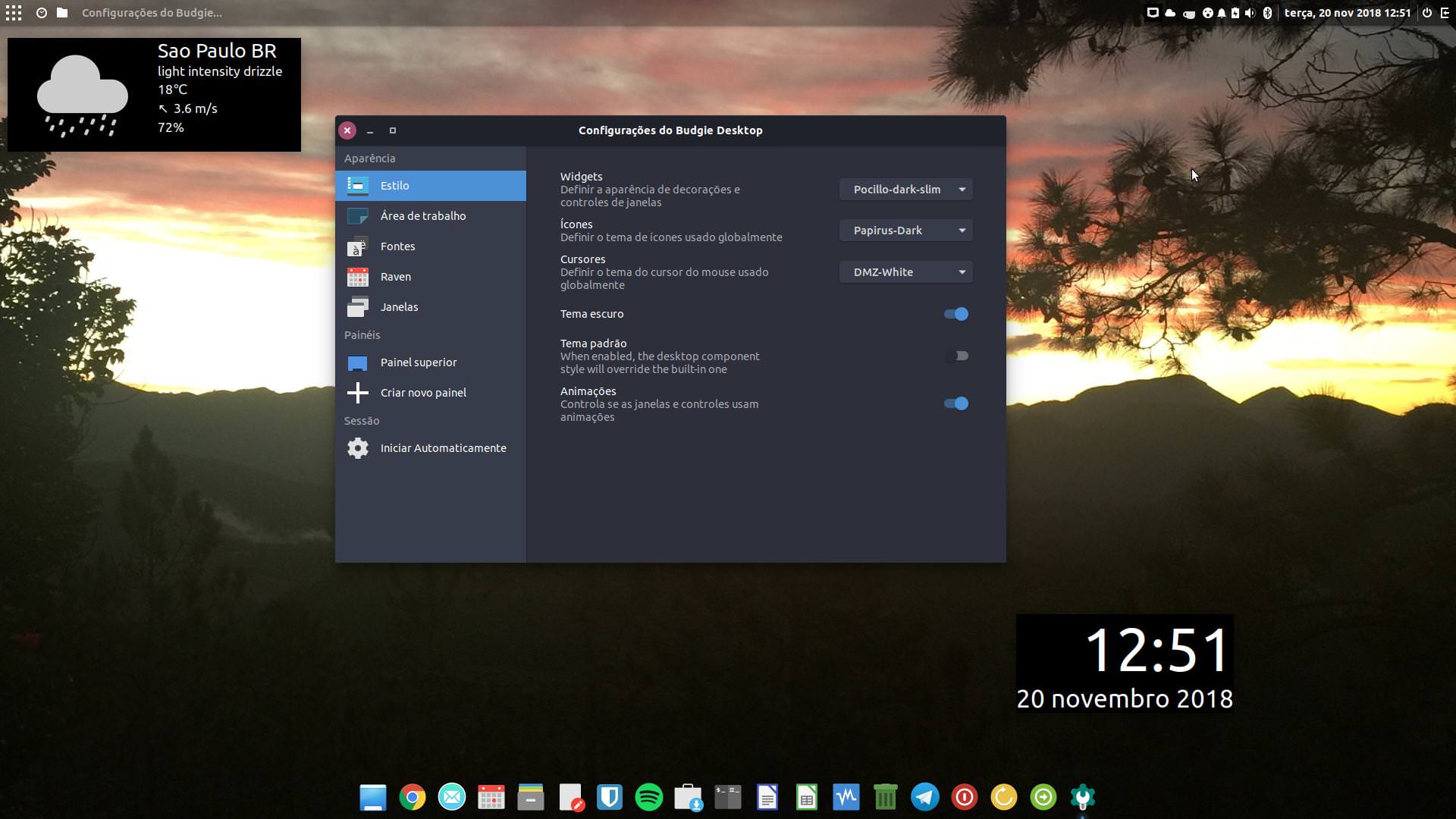

Can you please add a screenshot?
Also - if you run budgie-panel --replace & are there any warnings or errors displayed in the terminal?
here are the messages that show up.

If you change the theme to Pocillo-dark-slim does the background reappear? Just wondering if this is a specific issue with that “Sierra-dark-thin” gtk theme
I chnaged the team and the reboot it. but the issue remains

Thanks! Iwas checking the configurations of my laptop (Dell Inspiron 7472) have 2 GPUs a Nvidia Geforce MX150 and a Intel UHD Graphics 620.
