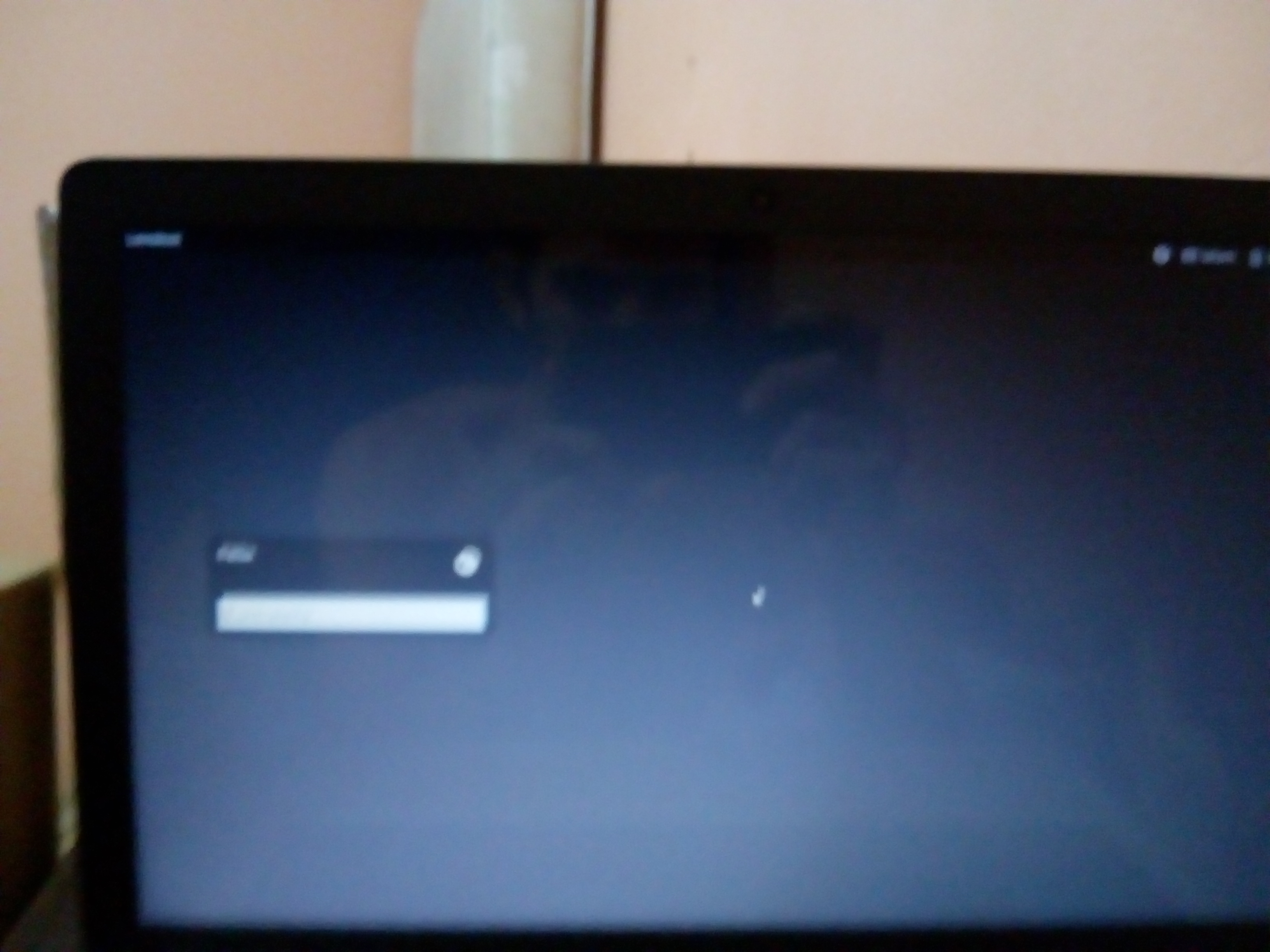

So. Today I was trying to use my computer and found this.
When i tip the right password, the screen blacks out and goes back to that screen.

Ctrl+alt+f7 to switch back to a graphical login and try logging in again

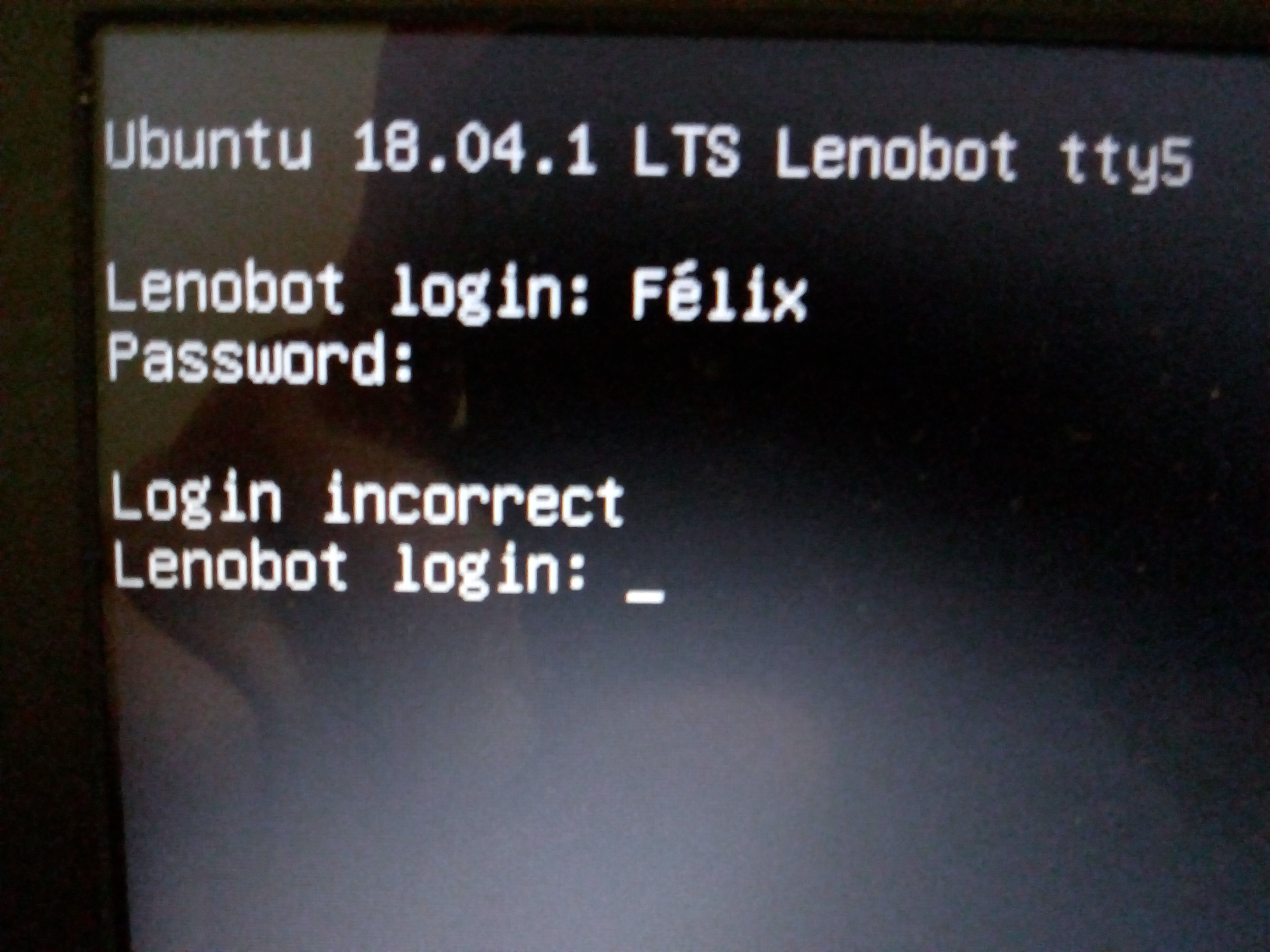

When i’m there, I try to log in and the answer is this:

Since you cannot log in using your normal account you will need to reset your password
Please follow this advice on how to do this

« Félix » as a login name may look strange.
Don’t misread me, it’s a nice name but login names are usually only lowcase and without accents.
Did you try with Ā« felix Ā» ?
@fossfreedom well no reproach as it can be helpful but resetting password should remain a kind of last survival emergency kit, lol.
Good spot! I didn’t notice the username but was concentrating on the fact that the OP couldn’t login.
The name with the uppercase and acent used to work.

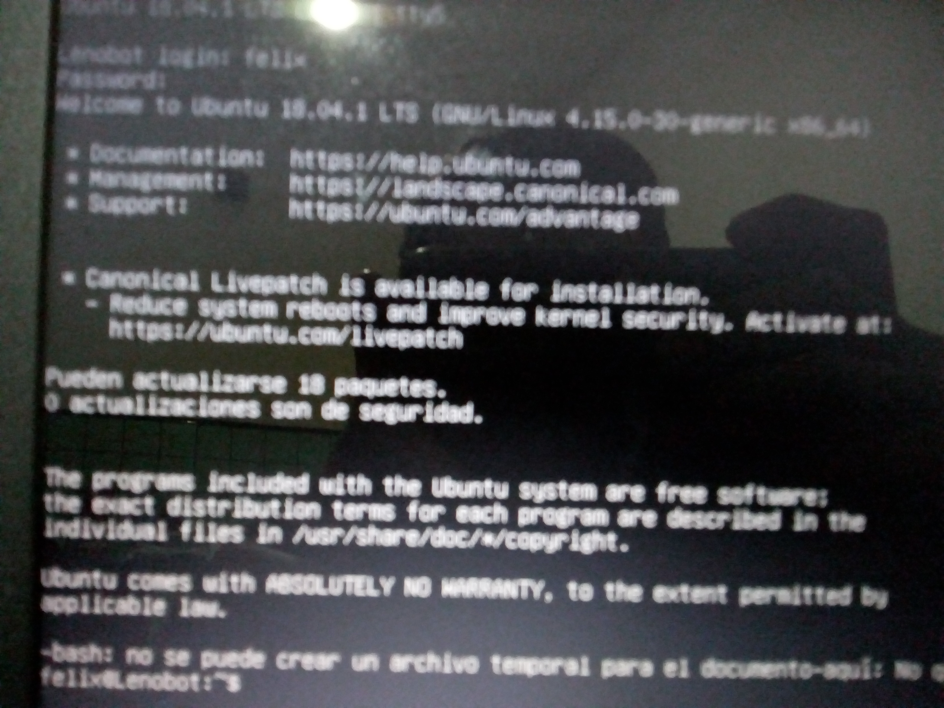

When I try with felix this is what appears:
IMG_20180823_201022
Didn’t try that. Thanks Coeur.
In the last line it says in spanish that it cannot create a temporal file because of a lack of sapace in the device.

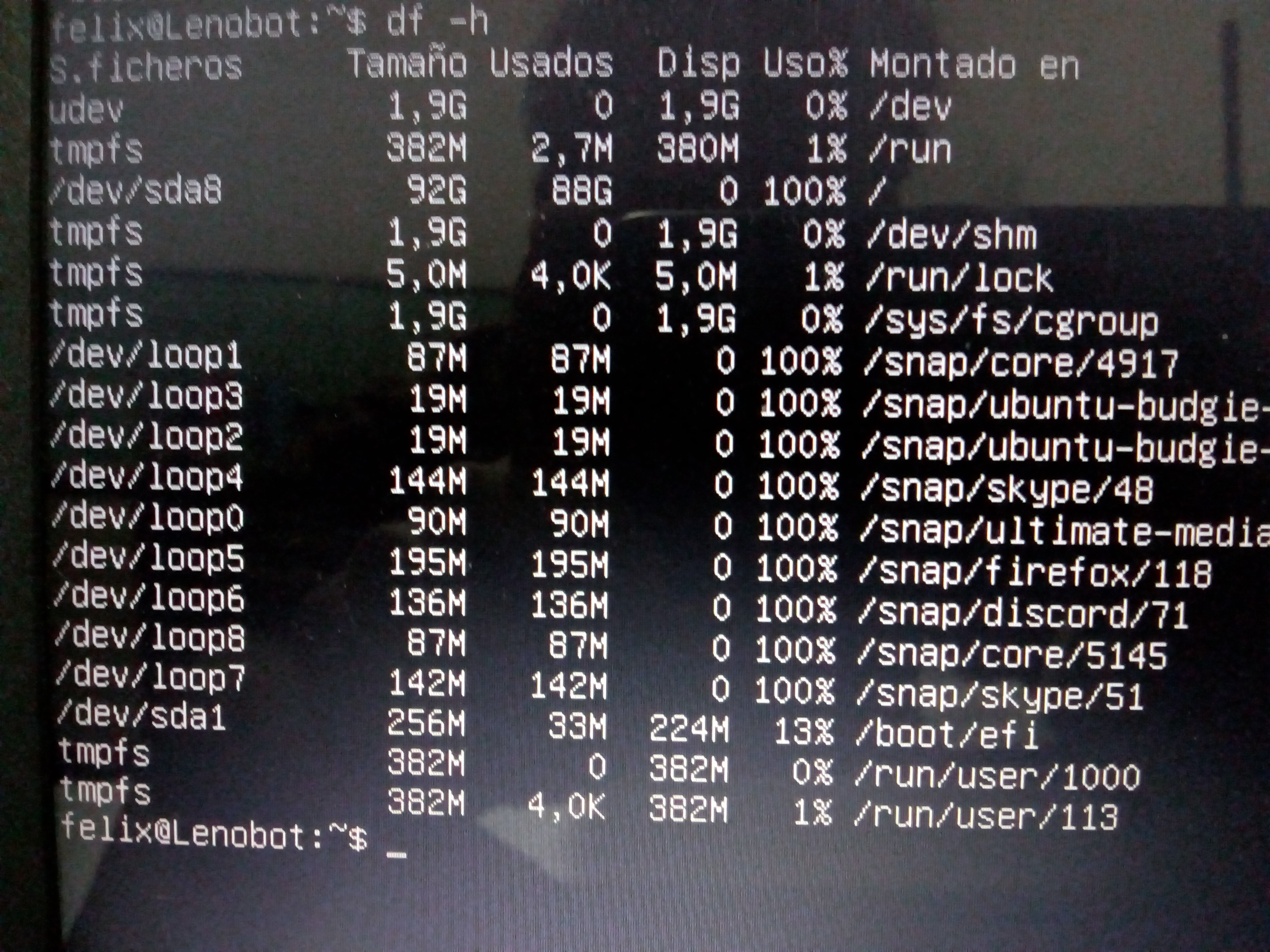

Does it sound possible that your disc, or that partition of disc, is Ā« full Ā» ?
df -h
will show storage capacity of your partitions.
ncdu
is a simple tool to check your disk usage ( use ←↑↓→ keys to browse ) and eventually delete files and folders ( hit d key as delete and ? for help ).

Anyway I am not sure a full disk explains why you can’t acces your desktop.
It’s quite possible.
IMG_20180823_225910
I think it’s jus showing the partition it made for Budgie when I installed it. I left 100gb or so for the OS to use.

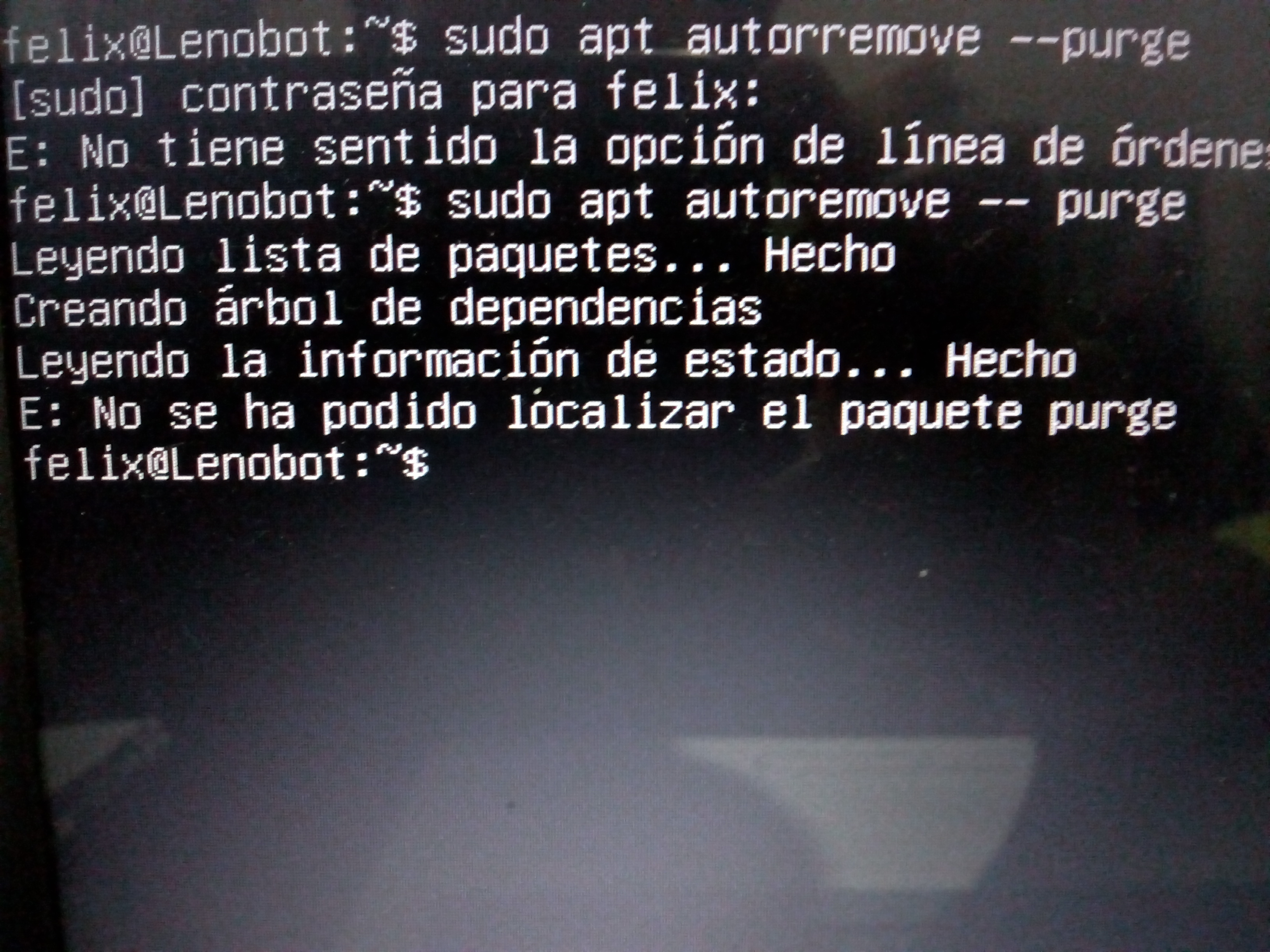

Installed ncdu, ran the autoclean successfully, the - - purge command gave me this answer:
IMG_20180823_232157
I’m also not sure if the full partition is the problem. But my current password seems to work well.

yeah - 100% will cause issues such as not being able to login.
The command is
sudo apt autoremove --purge
there is NOT a space between the dashes (–)

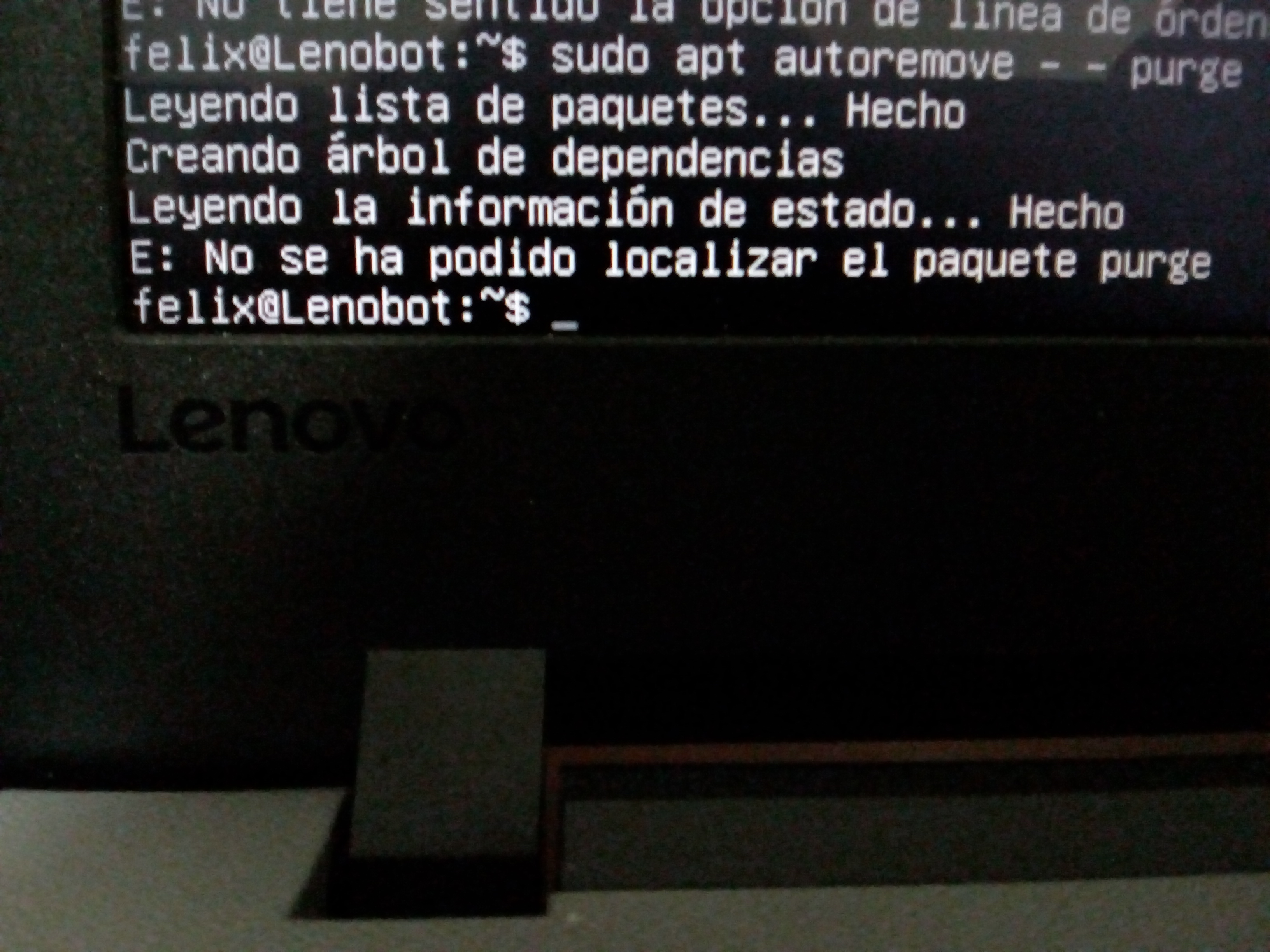

IMG_20180824_173314
On the last line it says something like:
E: purge package couldn’t be found.

There should not be a space between --purge
Another typo.
No space after the two - it’s –purge and not – purge as shown on your picture.
( well true that the font or its spacing on this site is not perfect, two short - look as one long – in plain text and in code two - show a bit much space between them )
Wherever applicable, copy and paste are better for avoiding typo.
[ wouaouw, same answer at the same moment :wink: ]
Yeah. At the first try I wrote it witout the space and it responded something like:
E: that line of order doesn’t make sense.
The second try I left a space to see if that worked.
